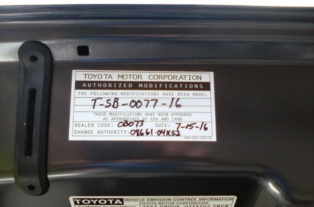

    Also, they did not affix the sticker as mentioned or used chalk/white permanent marker like some of you guys. So I really will be feeling out the truck the next couple days

    Do you need to know, or care?
    That looks a little more professional then some guy with a crayon.
