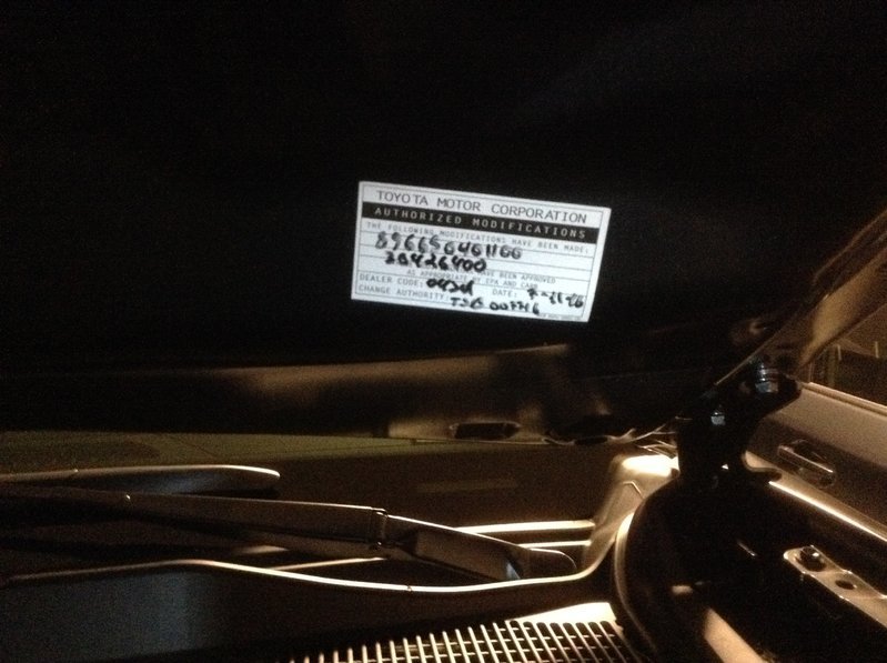

  5. Jul 23, 2016 at 5:52 AM
    #805
    WBF610
    WBF610 Member well known
    Aug 25, 2015
    #162672
    22,332
    Carey
    Eastern PA
    2016 DC OR
    mats, flaps, and stickers. Extang solid fold 2.0. Mobtown sliders and full skids. AVS vents
    Nice catch!

    So proud of my sticker. We need to start a new thread "show your sticker."
