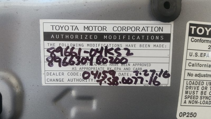

    KevC Well-Known Member
    Mar 28, 2016
    #182663
    750
    I only see 2 codes. Does this mean only 2 out of 3 issues were addressed?
    Anyone else's sticker only have 2 codes?

    KevC
    Mar 28, 2016
    #182663
    750
    Can you post your sticker under the hood?
  13. Jul 27, 2016 at 5:14 PM
    #973
    brizower
    brizower Well-Known Member
    Jun 22, 2012
    #81102
    284
    Andrew
    NorCal/Upstate NY
    2016 TRD Off Road
    Yeah... once it drops below 200° I'll go back outside.

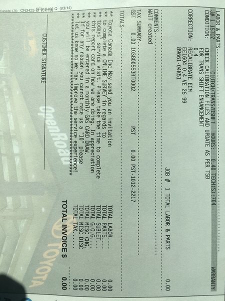

  18. Jul 27, 2016 at 6:21 PM
    #978
    ÜberToyota
    ÜberToyota Well-Known Member
    Nov 24, 2015
    #170611
    107
    Jay
    PoCo BC Canada
    2018 MGMDCLB TRD SPORT TECH PKG
    ROLL-N-LOCK Cover, Rear Tailgate Actuator Lock, 26570R17 BFG K02
    My TSB from earlier today's ECU upgrade in Port Moody BC these guys were awesome. Looks they referenced my last visit TSB number to the printout I showed them from the first post by the op. Thanks again!
    Not sure what some of the numbers were but a few matches the TSB found in this thread.
    Damage Inc and Zeeks82 like this.
  19. Jul 27, 2016 at 6:38 PM

  20. Jul 27, 2016 at 7:08 PM
    #980
    Zeeks82
    Zeeks82 Member
    Jul 18, 2016
    #192342
    7
    2016 Barcelona Trd Sport 4x4
    Nice work ubertoyota. Much nicer to drive isn't it? I'm glad other Canadians are finally getting it as well.
    ÜberToyota likes this.
