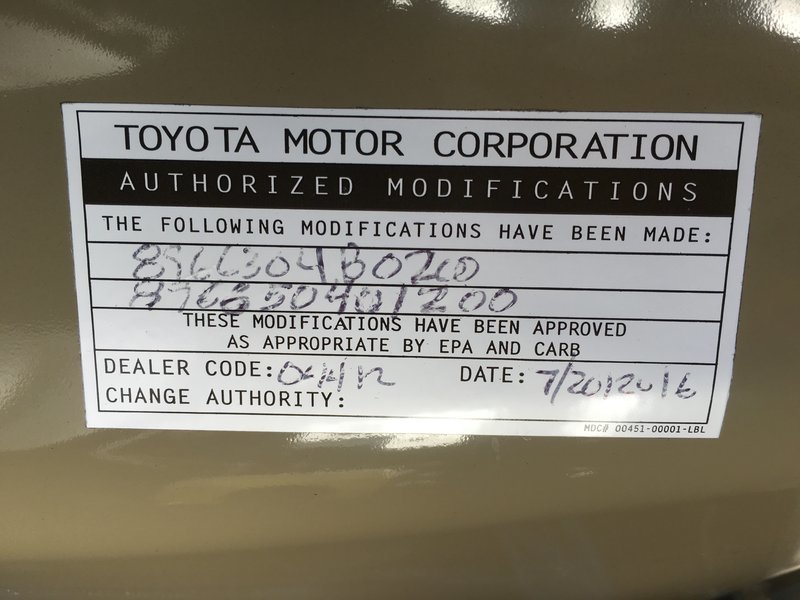

    image.jpg Two weeks now and REALLY liking the improvements. Was under the hood today and saw this sticker and thought I'd post it.
    NorCalTaco likes this.
