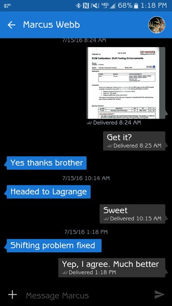

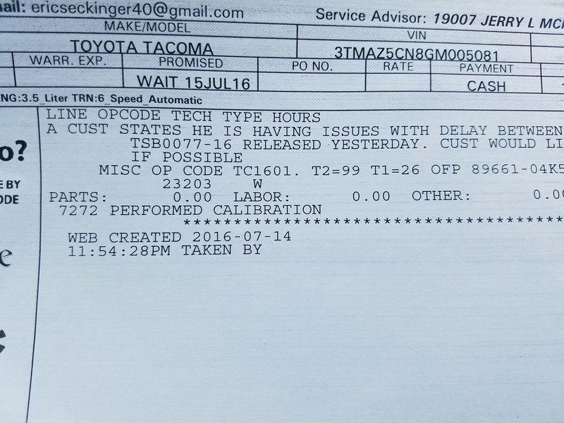

    Just got this from my buddy in town with the same truck.
