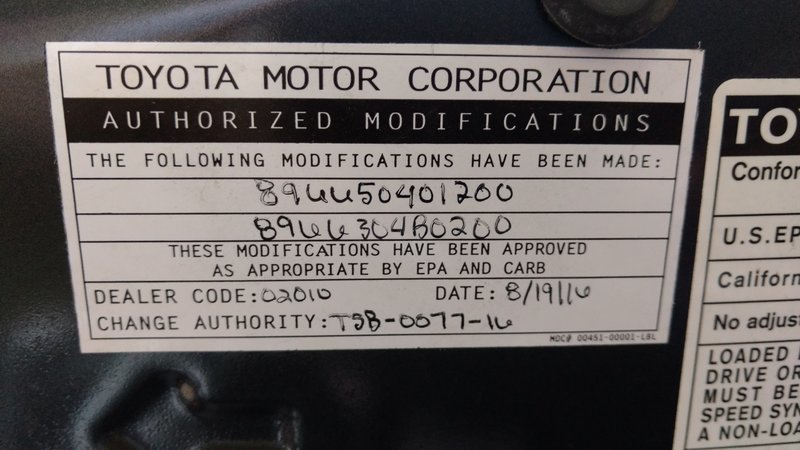

    I had the TSB done a few weeks ago. I want to make sure that they applied the sticker. Is it under the hood?

    Yep. Adjacent to the hood latch.

    Thanks! I'll check it out.

    I had the TSB done a few weeks ago, but no sticker under the hood. Should I go back and ask them for it?

    Update on tsb done last Wednesday. I seen the master tech with laptop in the cab of my truck and seen him drive it out after 15 or 20 minutes. Paper work also said it was done. Looked for sticker and don't see one. I am sure he did it though. Assessment after driving this weekend. I think 6th gear is basically useless at freeway speeds over 68 - 70 mph. It just can't hold 6th gear at higher speed unless going on a decline. I am adding a afe cai as soon as it arrives. Not expecting much but just maybe a few more hp might help this issue at highwy speeds. If not, it needs to be regeared! Don't know if there is aftermarket 4.56 for the 3rd. Gens yet. Shame on Toyota for a huge failure in R&D and releasing this debokle on us loyal Tacoma fans!
