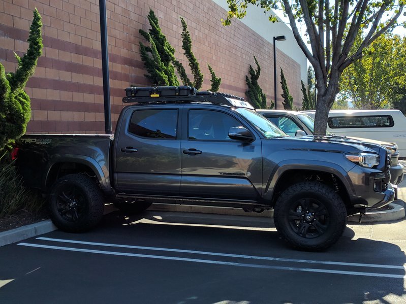

    Hey Everyone!
    After posting all over the forums asking for recommendations and advice regarding making modifications to my truck, I have come to the conclusion (in hindsight) that I should have started a build thread. So this is our build so far, I will continue to update it as things go along, so far this is what we have. Any advice/comment is welcome btw, this is an ever changing build :)
    Also thanks to everyone that commented on my other 9 million posts asking stupid questions, you've all helped me make it this far!
    Current Modifications
    - Prinsu Cab Rack.
    - Prinsu cab rack noise dampener.
    - Re installed weather proofing for cab rack mounts, and sealed them for moisture.
    - Icon Stage IV Suspension.
    - Icon Tubular UCA's.
    - Icon rear AAL.
    - Spidertrax 1.25 hub centric adapters.
    - SpartanXCustoms Power Distribution system.
    - SpartanXCustoms hood scoop light bar.
    - MicTunning Dual mode (amber/white) 31" light bar - recessed bumper. (disassembled and waterproofed)
    - CaliRaised Bumper light mounts.
    - Roof Mounted Cree LED Spot beam work lights. (disassembled and waterproofed)
    - Smoke Dark led covers for roof lights.
    - Waterproof, heavy duty cabling for all power distribution components.
    - Shapeways custom 3D printed button panel for the inside of the cab. (makes it look stock-ish)
    - Iztoss Toyota blue LED push switches for bumper, scoop, roof and fog lights.
    - American Flag recessed vynil door stickers (+10HP).
    - OB emblems.
    - Dual Plano 108362 roof mounted weatherproof cases 36".
    - Door Sill protectors.
    - Smittybilt receiver hitch D-ring.
    - K&N Performance air intake.
    - Modified the bed to add 4 x d-rings on bed mount points.
    - RCI Hi-lift mounts.
    - 8 layer dip on stock wheels.
    - Blacked out all emblems and chrome parts. (Not sure why toyota ships these things with so much chrome).
    - Passenger side floor mat eyelet holder things (the passenger side mat slides around when stock).
    - 285/70/17 BFG KO2's.
    - Bed mounted spare.
    Future modifications (have parts, have not installed yet).
    - BAMF Cab mount chop plates.
    - Toytec extended reinforced brake lines.
    - Toytec 1" body lift
    - OME Carrier bearing drop kit.
    - Diff drop kit.
    - Icon Hydraulic bump stops.
    - Front rubber bump stops (bigger than stock)
    - rear roof rack mounted WaterPort
    - roof rack mounted rotopax (fuel and water cells)
    - roof mounted maxtrax
    - ARB differential and transfer case breather kit.
    - RCI lca, front, transfer case, transmission, fuel tank and read diff skid plates (aluminum)
    Future FUTURE modifications (since being placed in buying freeze by the wife, i have not bought any of this yet).
    - C4 Fabrication front bumper.
    http://www.c4fabrication.com/produc...verland-series-front-bumper-full-size-no-cut/
    - C4 Fabrication rear bumper (high clearance)
    http://www.c4fabrication.com/produc...and-series-high-clearance-rear-bumper-system/
    - Expedition One Rock Sliders.
    They're not available on the web yet, but i have been talking to them for a few weeks now about these.
    - Bushwacker fender flares.
    - SCS wheels (waiting on them to go back into production).
    - ARB Safari snorkel.
    Here it is.
