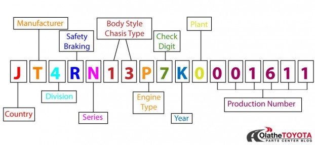

    Sorry about the confusion. ...2017 can't be the build year, of course. But I'm wondering if the 10th digit (letter G) is supposed to indicate something else.

    As a complete guess, if it is model year A would be 2010. So G would be 2016 start from zero not 1.

    • A – 1980 OR 2010
    • B – 1981 OR 2011
    • C – 1982 OR 2012
    • D – 1983 OR 2013
    • E – 1984 OR 2014
    • F – 1985 OR 2015
    • G – 1986 OR 2016
    • H – 1987 OR 2017
    • I – Doesn’t exist. You’re looking at the number one.
    • J – 1988
    • K – 1989
    • L – 1990
    • M – 1991
    • N – 1992
    • O – Doesn’t exist. Neither zero or the letter “O” are used as the 10th digit.
    • P – 1993
    • Q – Doesn’t exist.
    • R – 1994
    • S – 1995
    • T – 1996
    • U – Doesn’t exist as it’s too easy to confuse with the letter “V”
    • V – 1997
    • W – 1998
    • X – 1999
    • Y – 2000
    • 1 – 2001
    • 2 – 2002
    • 3 – 2003
    • 4 – 2004
    • 5 – 2005
    • 6 – 2006
    • 7 – 2007
    • 8 – 2008
    • 9 – 2009
    • A – See beginning of list

    Thanks guys,
    Makes sense, the G in 10th position is for the year 2016.
    But, based on the new document Toyota issued to the DOT, http://vpic.nhtsa.dot.gov/mid/home/displayfile/29213,
    the diagram above is no longer completely correct. Some of the VIN positions are the same, but several positions have changed from that diagram.
    For example, I am given to understand that the VIN for my new vehicle, 5TFHZ5BN8GX007116, indicates the following:
    Posn - Digit/Letter:
    1- 5 Country of origin (USA)
    2- T Manufacturer (Toyota)
    3- F Vehicle Type (Truck)
    4- H Body type and grade (double cab, limited grade, super-long wheel base, four wheel drive)
    5- Z Engine Type (2GR-FKS / Gasoline Port + Direct, V6, 3.5L)
    6- 5 Restraint devices and their locations:
    - Seat Belt: all seats
    - Frontal airbag: Driver and passenger seats
    - Curtain shield airbag: all rows
    - Side airbag: first row
    - Knee airbag: driver and passenger seats
    7- B Series: GRN310L
    8- N Line and Make: Toyota Tacoma
    9- 8 (same position) a check digit to verify authenticity of the VIN. A number obtained using a mathematical formula
    10- G Model Year (2016) (...or is that year built, i.e., 2017?)
    11- X Plant (Toyota Motor Manufacturing, Texas, Inc., San Antonio, TX, US)
    007116 production number. They are usually used to show literally the unit’s number as it went out the assembly line. So this means 00004 is the fourth car of the respective year model produced AT THAT PLANT.
  6. Mar 7, 2016 at 3:56 PM

    The 9th digit is a check digit calculated from all of the other digits, that is correct.
    10th digit is model year:
    A = 2010
    B = 2011
    C = 2012
    D = 2013
    E = 2014
    F = 2015
    G = 2016
    Jeff
