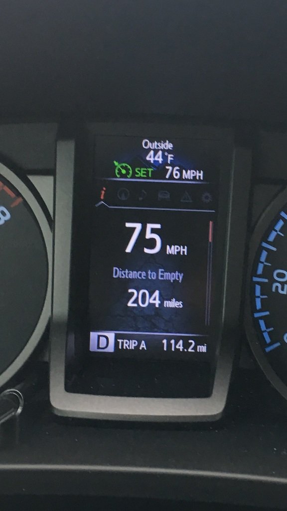

    Any resolution for this? My 2019 is doing the exact same thing...gotten all TSBs done and filled trans fluid which was low 1 quart. I get average of 17-20 mpg city now, but transmission wont shift out of 5th on highway with cruise on, unless i bump gas pedal or use sport manual shifting. Even when using sport manual shifting it will shift on its own back to 5th and runs at 3-3.5k RPM. Plus 90% of the time i set my cruise, it sets itself 1mph above the speedometer. Set it at 75, speedo will read 74 causing trans to stay in 5th gear trying to reach set speed....This is the only remaining issue with my 3rd gen and its causing me to get 10-15mpg highway.
    Anyone have a resolution or fix for this, besides OVTune or PC? Thanks TW!
