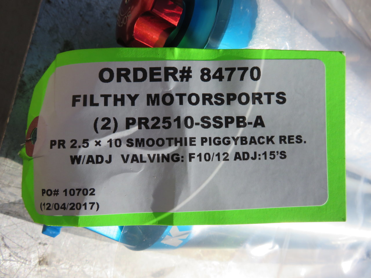

    @Maxcustody, saw your post in the King thread. Again nice truck. I'm doing a very similar set up, but wasn't planning on doing the piggy backs in the rear. Any particular reason you chose those? Do you have a part number? Can't find it on the King website, but it's kind of beeatch to find anything on there.
    Also, was the shock relocate necessary? Wasn't planning that either, but maybe necessary for the Deavers? I'm going to need to look into that.

    Thank you.......... I ordered everything from Filthy motorsports. Piggybacks were done due to the King bumps and where they are located in relation to the shock relo kit, as well as the fitting for a remote reservoir would not be able to clear the shock hoop.
    To do it right and replace the springs with Deavers relocating the shocks were necessary for me and what I wanted out of the lift. A lot of guys just use the stock mounts and throw in Dakars or whatever they prefer.
    Here is the tag from my rear shocks. All of the shocks were built, valved and tuned to my specific weights and needs of the truck.

    Boo-Yea! Thanks for the info.

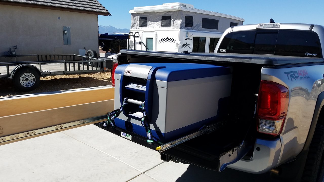

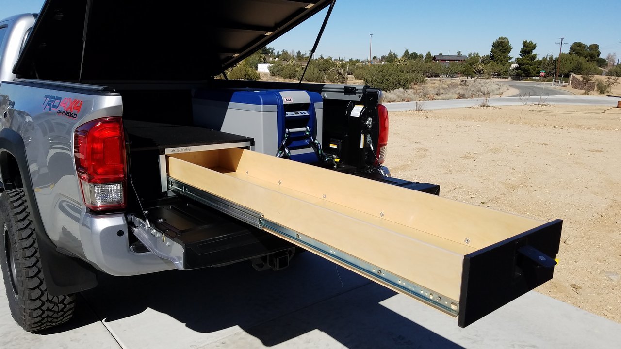

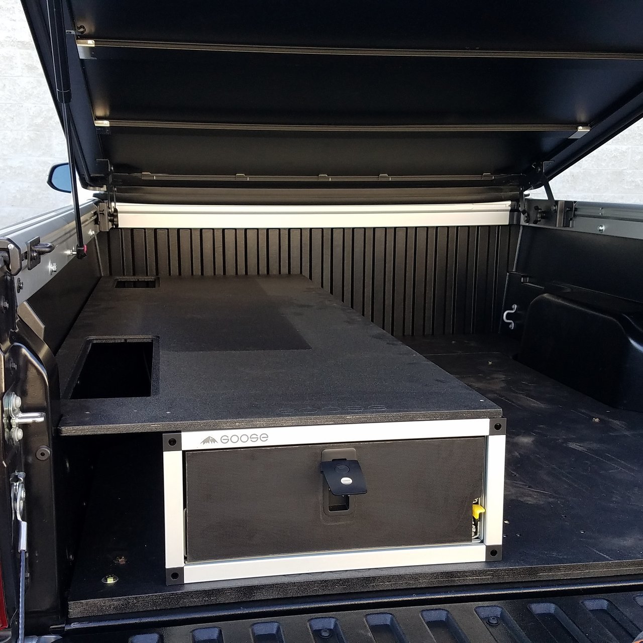

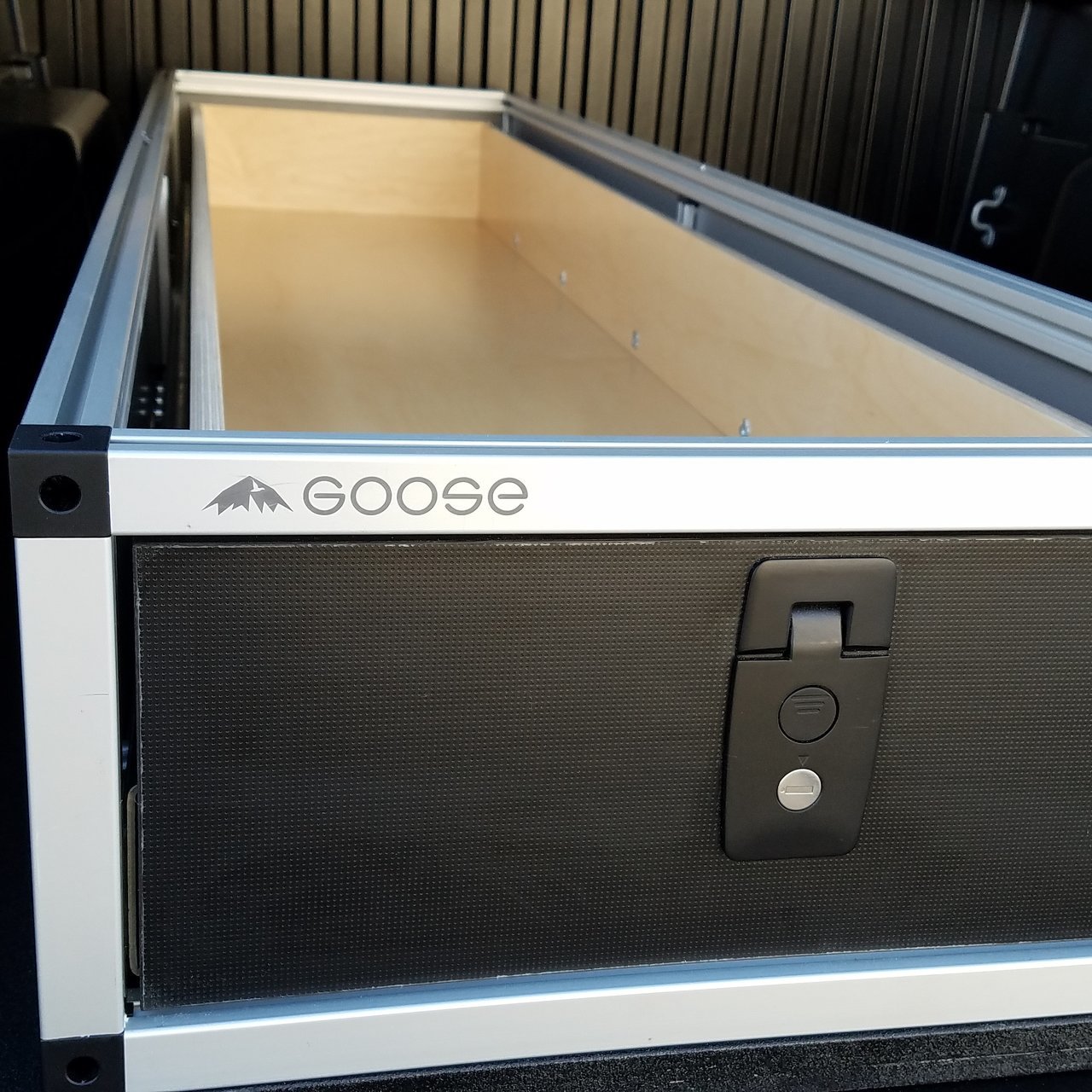

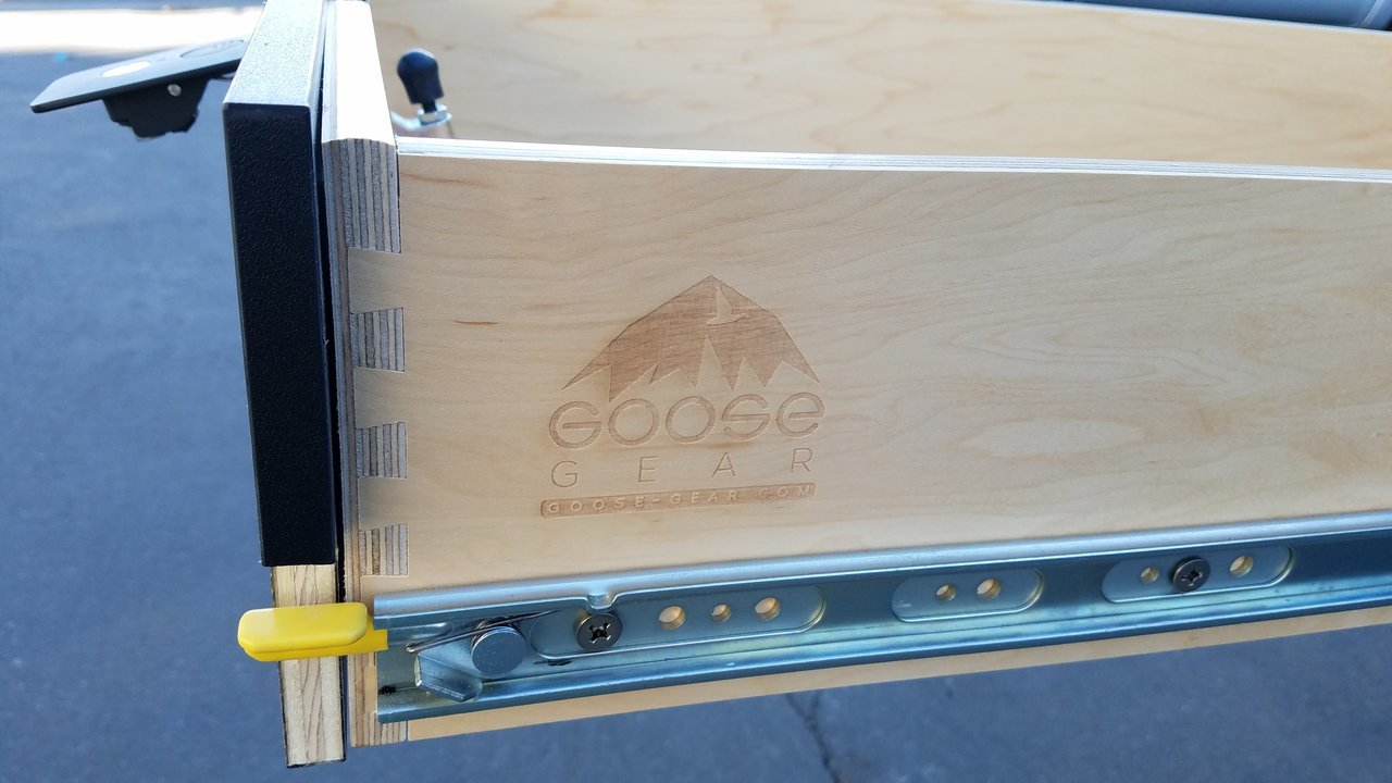

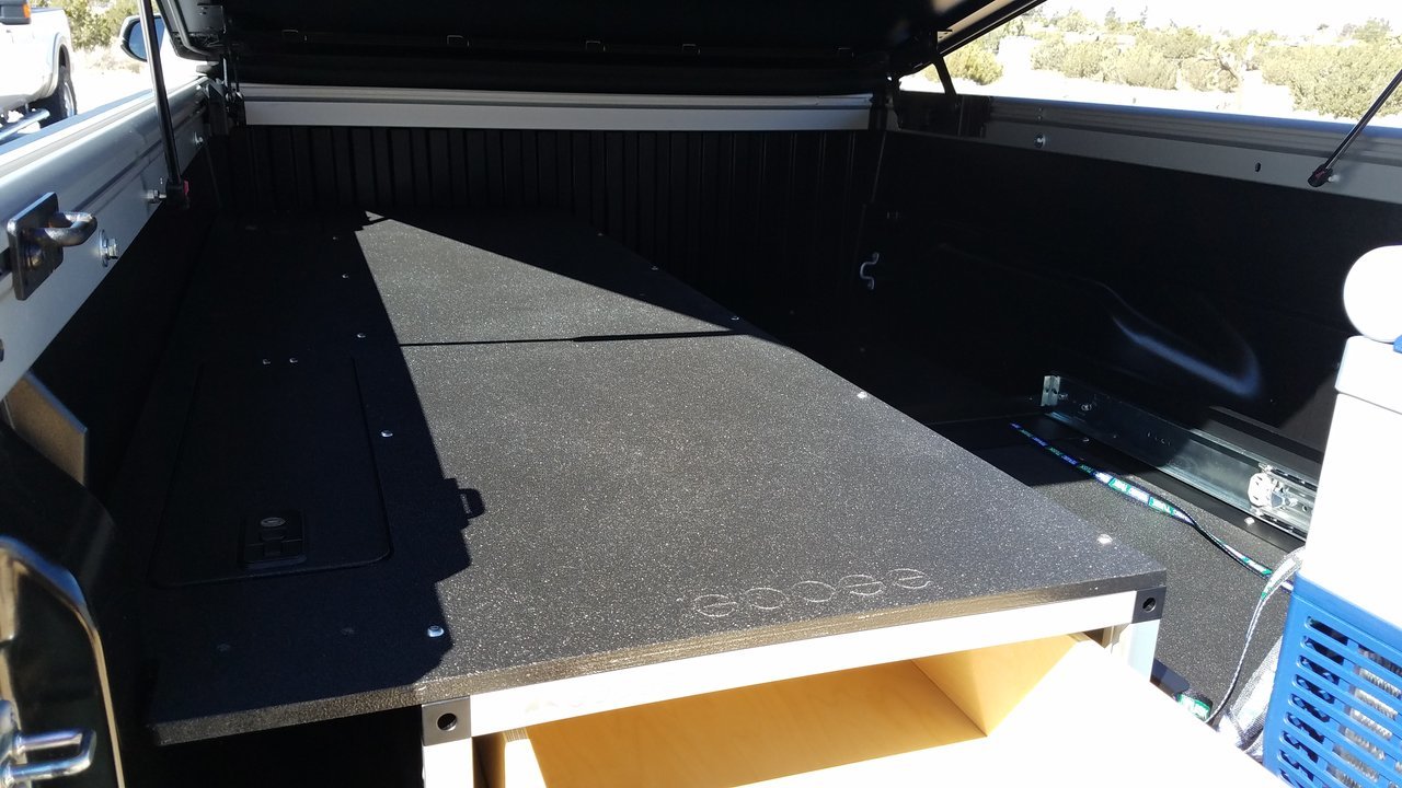

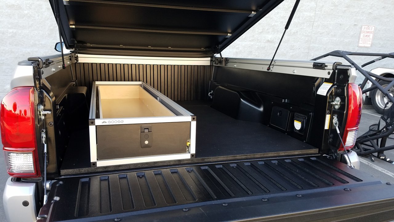

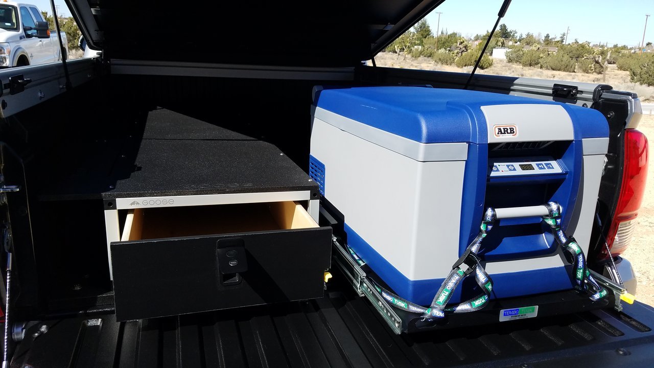

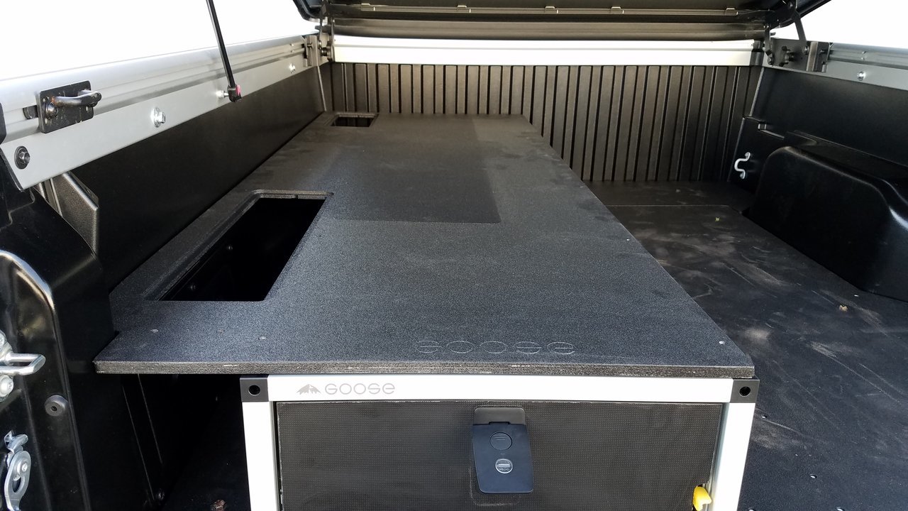

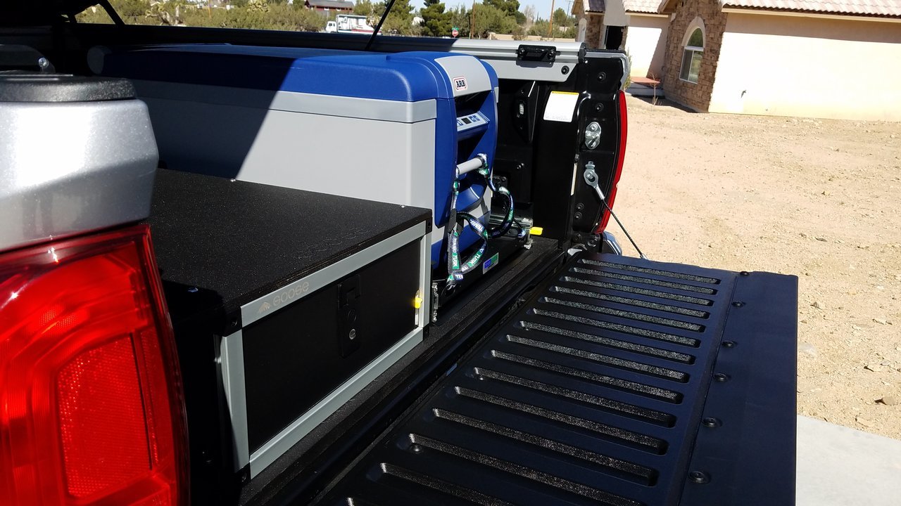

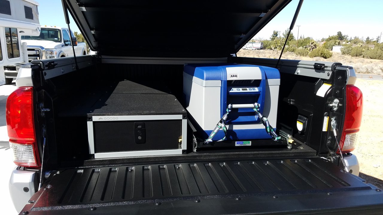

    Goose gear install happening now.......

    Finished up.....outstanding!

    Looks clean. Nice job!
