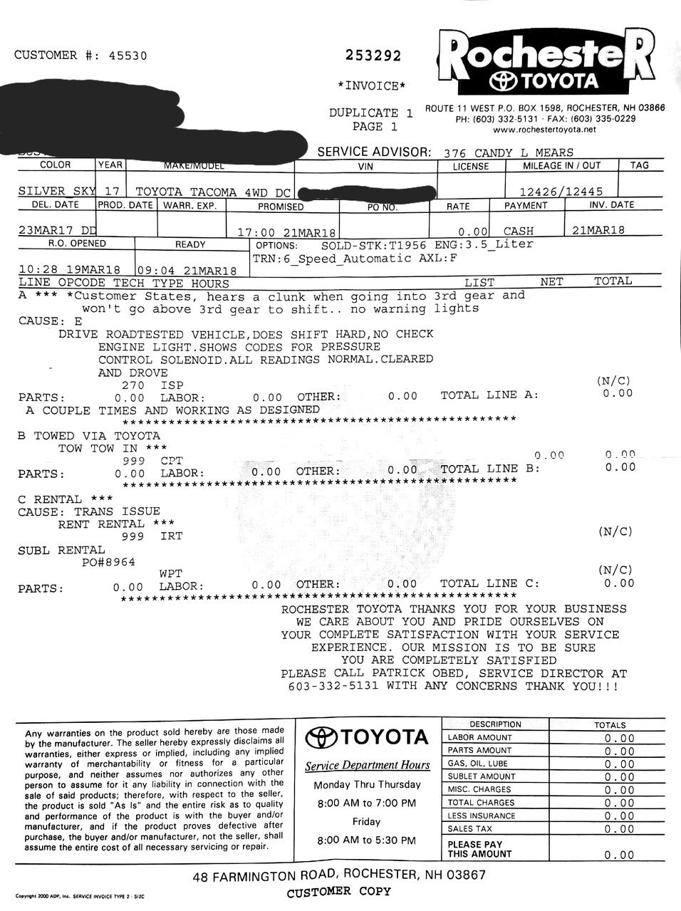

    Limp Mode as mentioned earlier in this thread is designed to prevent further damage . This is an excellent feature that has been around since the late 90,s
    In the OP,s case , the computer in his truck saw a " glitch " and prevented the transmission from selecting the overdrive gears .
    I would also be interested to see the work order . If there is truly something going on with the transmission , its better to catch it now rather than wait for more serious side effects .
    I am in for the rest of the story . In my opinion , a " Glitch " is not a word associated with transmission diagnostics . I wouldnt accept this as an answer to the problem .
    What codes were set ?
    Are you interested to find out whats been done to your truck while it was on warranty or another owner ?
    Type in your VIN # and see what,s been done to your truck at the dealership
    http://www.toyota.com/owners/web/pages/home

    @Romy
    "Shows code for pressure control solenoid"
    Did they give you any info on which codes were present before the tech "cleared them" ?
