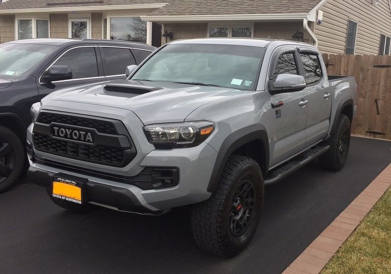

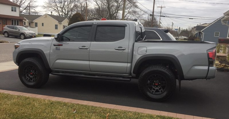

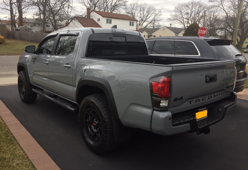

    I just put 285/70/17 Nitto G2's on my PRO. All I had to do was trim alittle bit off the inside front fender lining. No more rubbing at all. I went with a 17x8 wheel with +5 offset. I will provide pics shortly

    I just fit 287/70/17 Nitto Grappler g2's under my pro with 17x8 whhels and +5 offset. very Minor trimming on the bumper side of the fender liner. No rub now, even in reverse, going down a driveway in full lock.

    LOL, i was nervous as hell. Took me forever to pull the trigger on this tire/wheel combo but i'm glad I did. I was gonna get the Ridge Grapplers but I compromised because they were way too heavy in my opinion. I got the C rated G2's. Very happy with the decision. Very MINOR trimming needed. Only problem is they are a little noisy.
