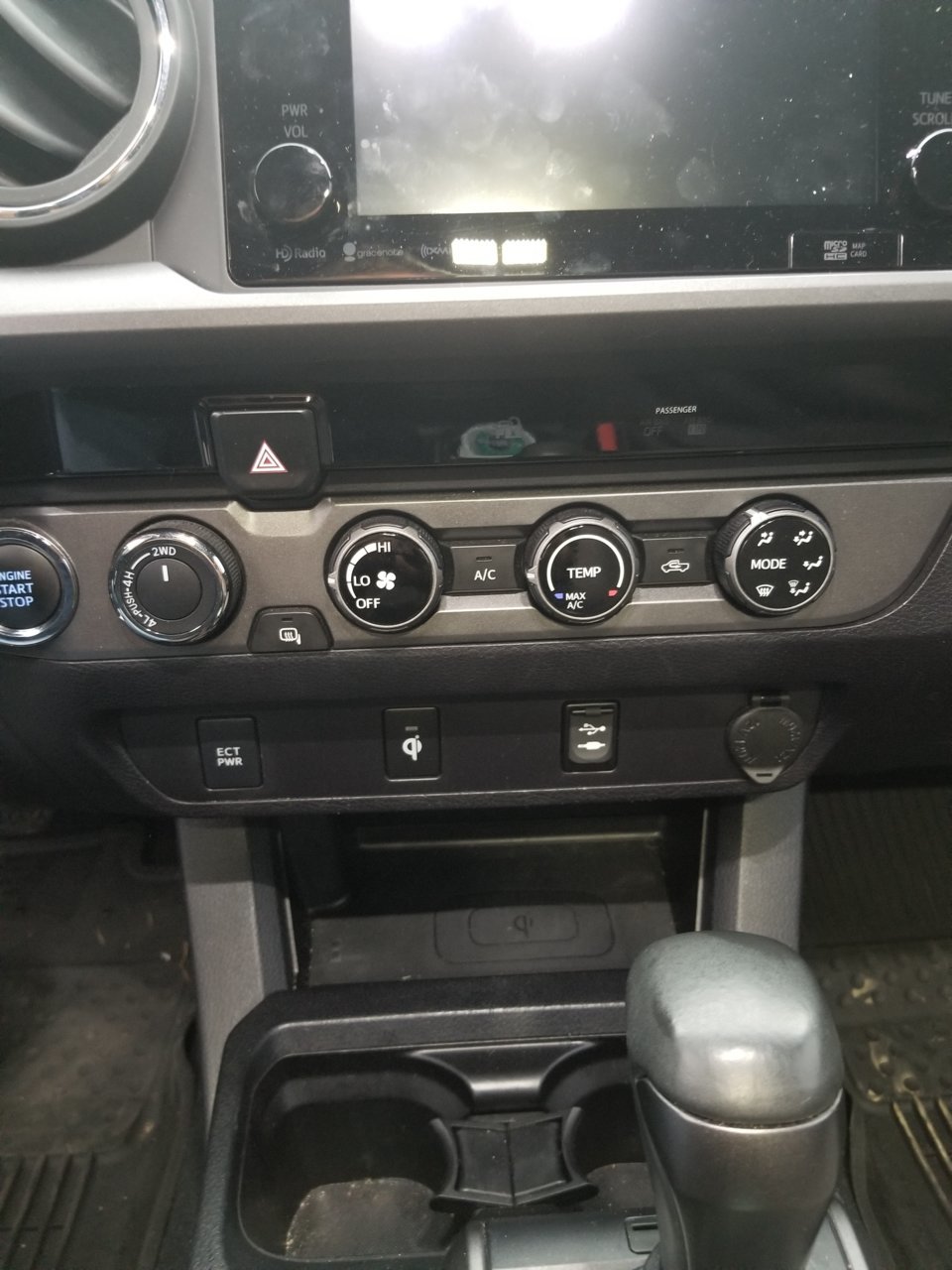

2017 Climate Control/AC IG1 No2 Fuse/MG CLT Relay
Discussion in '3rd Gen. Tacomas (2016-2023)' started by TheTraveler, Aug 11, 2019.
  1. Aug 13, 2019 at 5:43 AM
    #21
    shakerhood
    shakerhood Well-Known Member
    Aug 9, 2015
    #161370
    36,983
    Southern Ohio
    2017 MGM DCSB Off Road, 6 Speed MT, P&T
    Seems like you should be able to drop it off at the Dealer and they give you a loaner vehicle until they fix the problem, no use driving around with nonfunctional climate controls.
  2. Aug 13, 2019 at 5:48 AM
    #22
    TheTraveler
    TheTraveler [OP] The Traveler
    Mar 31, 2015
    #152178
    116
    Nathan
    Northwest Indiana
    2017 TRD Sport
    Not according to my dealer. Make an appointment, bring it in for diagnosis. If parts are needed, they'll send me home with the truck and have me come back when they're in. Reasoning is that it's running, can be driven, and not a safety issue. They also close at 6pm, so whoever said that all dealers have evening service hours, that's apparently not true.

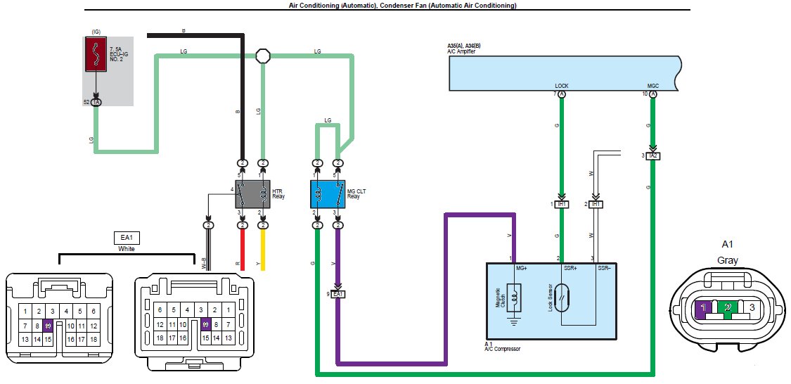

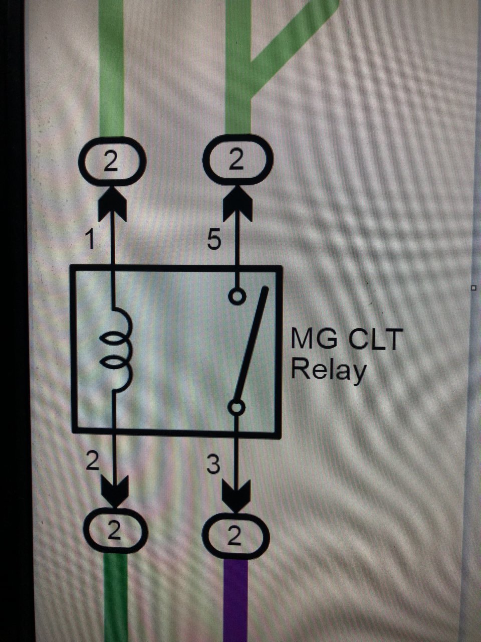

    Well now we've got something. Whatever this is, only happens when I start the truck. So I went under, pulled the fuse, then looked it up on the chart: IG1No.2. What is this? I whip out my phone, Google the trusty TacomaWorld website and the fuse name, I type that in...wow! Now we're onto something. I find some things related to others having that problem, and I read up that others have had this issue with the Gen2, and it is related to the MG CLT relay. K, let's try it. Open the hood, pull that guy out, put a new fuse in under the dash, start the truck...all is well. Wait a few minutes. I've got everything plugged in, fan is blowing, all is normal. Not cold obviously because the relay is pulled, but I have just narrowed this issue to that relay.
    I put everything back together nice and neat. Head down the street and get a new relay, stick it in...fuse pops.
    So now I am at a crossroads. I can keep going and further look at this, as it seems it is pointing to some magnetic clutch or A/C amplifier issues that others have had, but at the same time, I'm still under warranty. My next appointment isn't until 4 days from now. At a minimum I've got the climate control and the fan up and running but still no AC, and I've saved the tech a little bit of digging.

    Look at VIOLET (#9) wire from fuse box towards A/C compressor, see if it's chewed, melted, rubbing, etc.

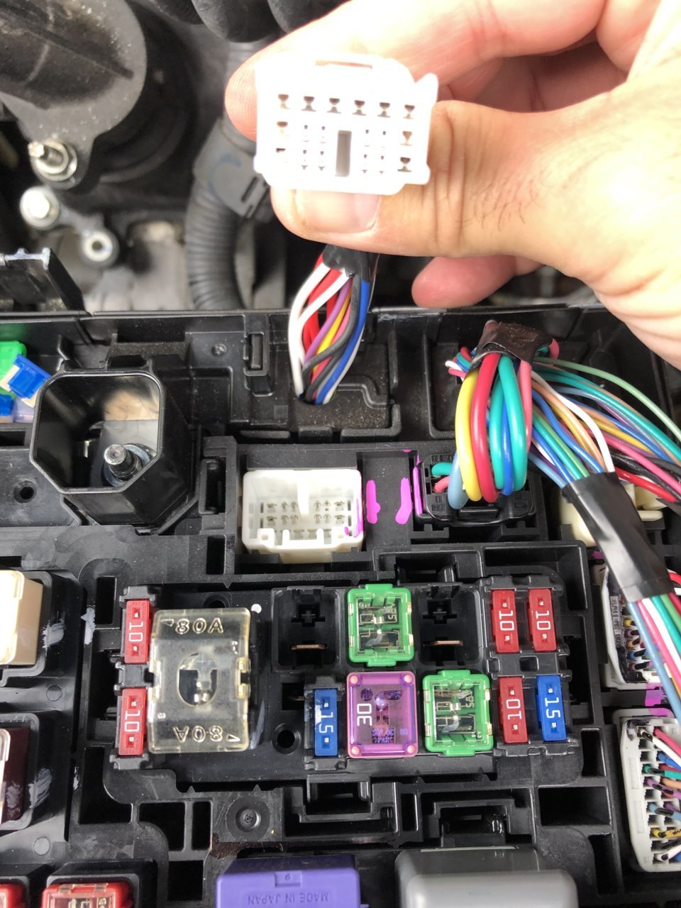

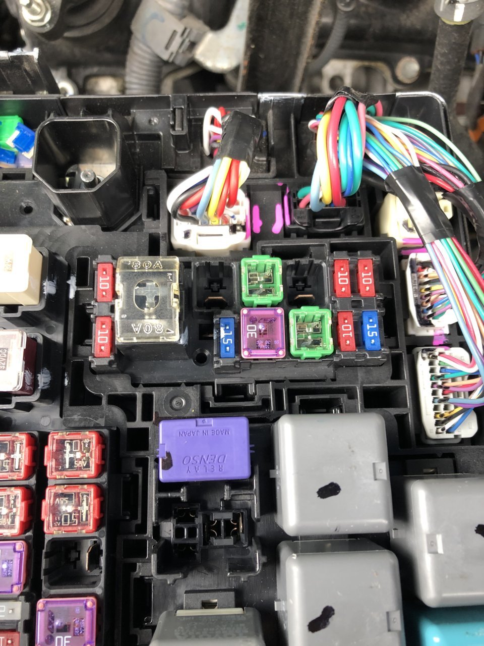

    Found it but can’t see anything unusual.

    It terminates in the rear of the Compressor. But at least it's nothing (so far) obvious.

    Edited to show the Fuse and compressor juice wire and connector.

    @caribe makaira is on the right path. I’d check that purple wire first.
    BTW the light green wires go to HTR Relay and both Fan relays.

    Also interesting that if I put the replay back in but make sure the AC is OFF, it won’t blow the fuse. When I turn the AC ON, the fuse will blow.
