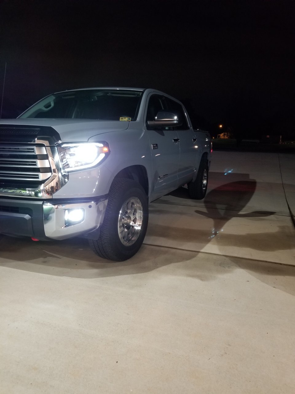

    5.7 is a tank too! I don’t know if I’d bet against it. It’ll smash a 3.5 longevity too from what I’ve seen depending on year.
