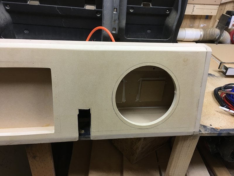

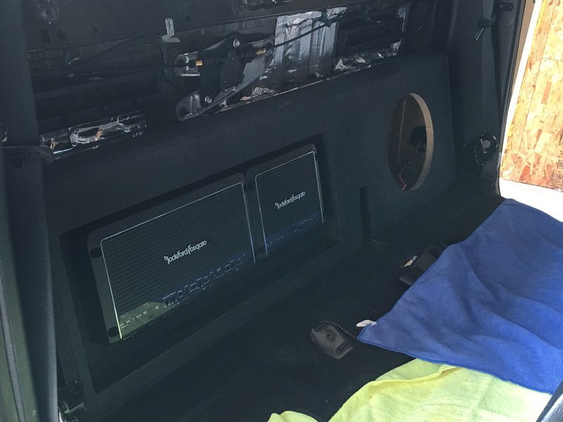

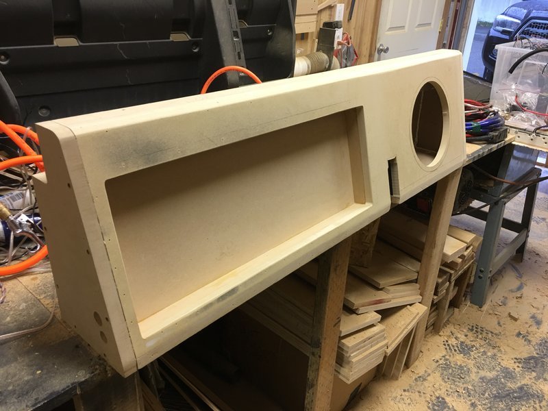

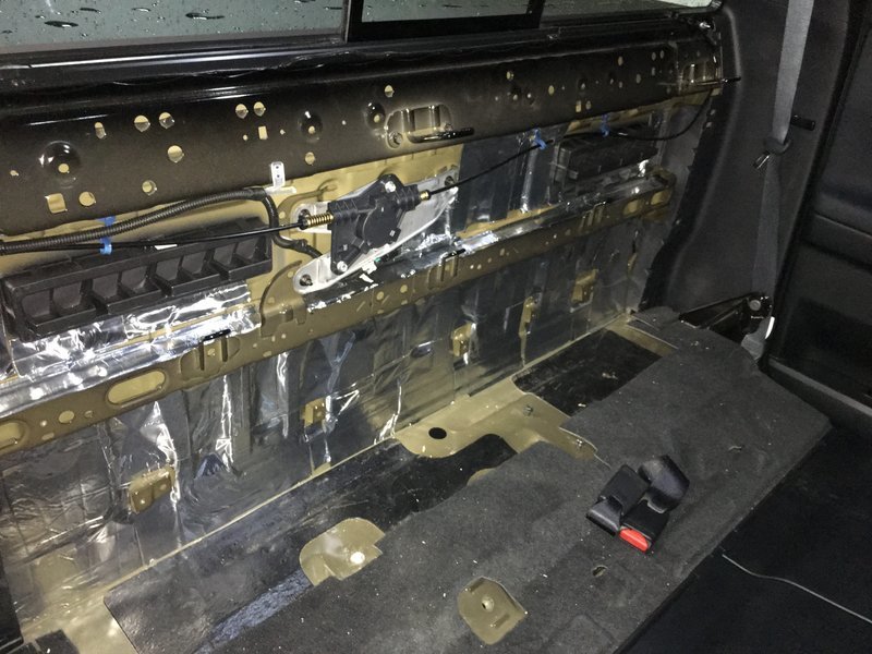

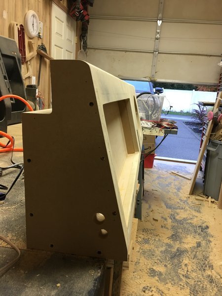

    So after reading, reading and more reading and gaining a lot of help from other forum members I finally began my system upgrade on my '17 DC. I couldn't find a lot of info on the '17 'cause it has the window motor on the back wall, but other than that it was pretty much similar to the '16. Right now I have my box installed and factory speakers connected to the amp. My sub shows up tomorrow so I will do that this weekend and I plan to build a facade to cover the box and wiring as well as building a plate to go into the cubby for the LC7i

    - Doors amp is R600x5
    - Sub amp is a R500x1d
    - Sub is a Rockford fosgate P3SD4 shallow mount 10"
    - Processor is a Audio Control LC7i which is mounted in the storage bin under driver side rear seat.

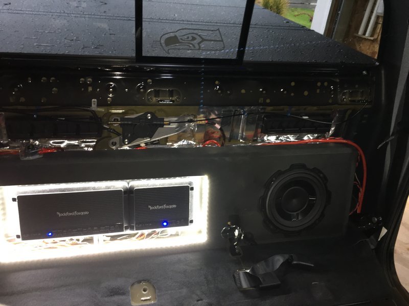

    Ok made some more progress today. Added the sub and some lighting.
    Still need to tune it and the sub sounds real hollow so I am going to add some polyfill in hopes that helps.
    TacoPretzel89 likes this.
