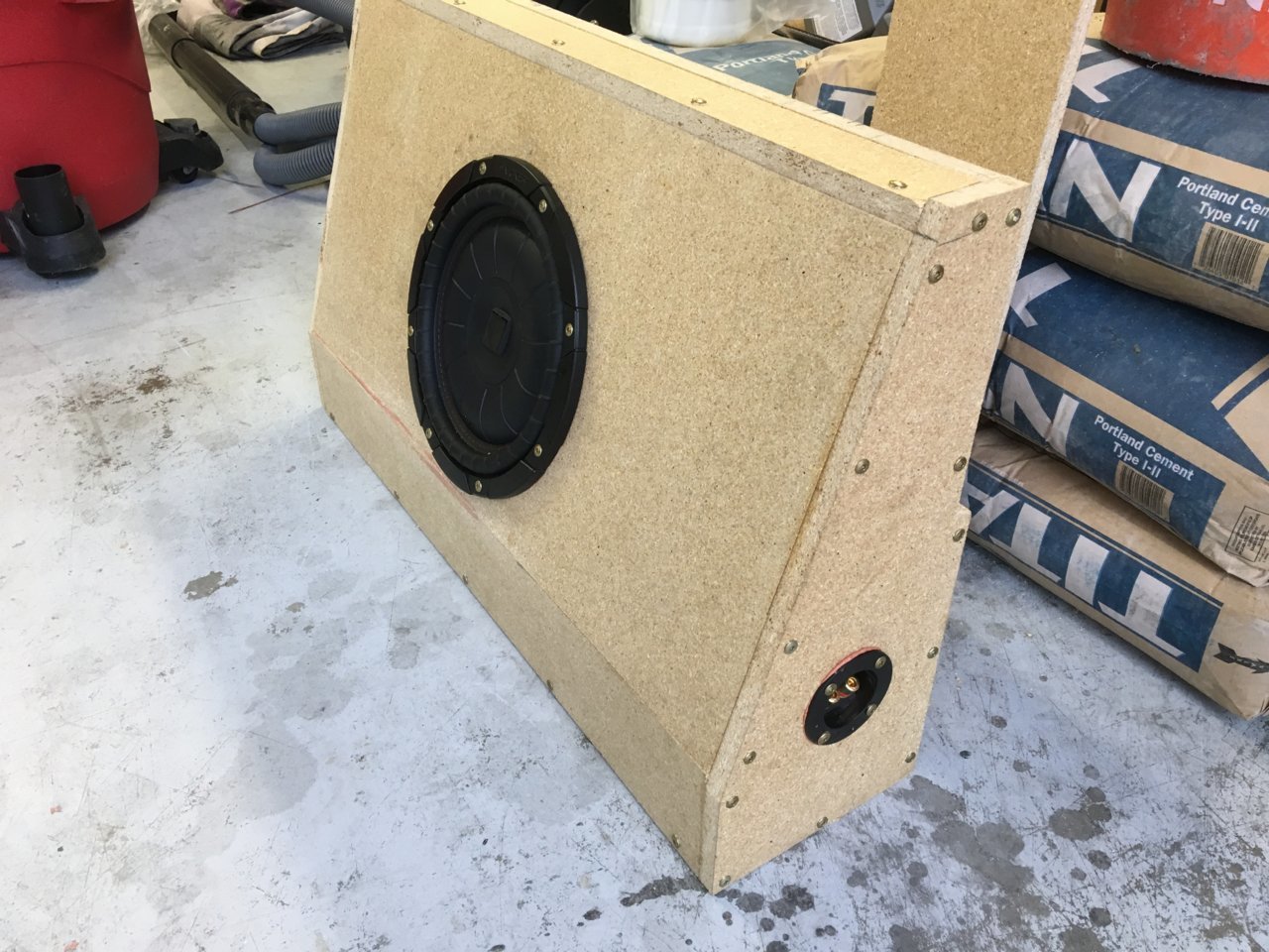

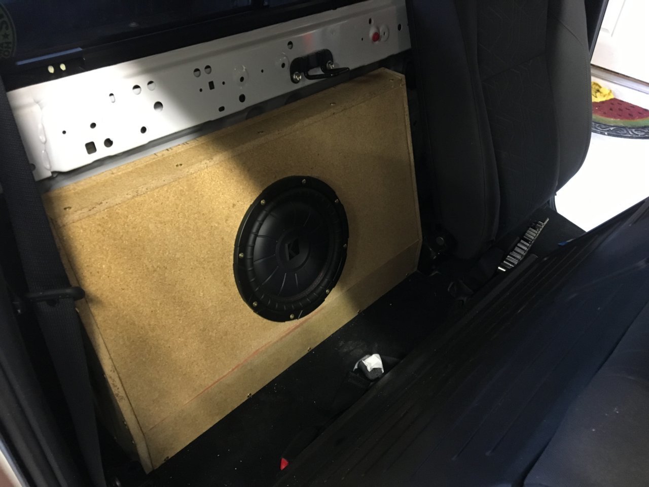

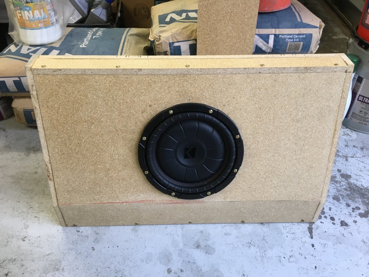

    I wasn't happy with the boxes that cover the full width of our trucks. I built a box this weekend... 5/8" particle board (was knicked on a corner at HD and cost me $4 total). It's nowhere near as nice as the furniture quality ones Mr Marv makes, but fits great and sounds good with a 10" kicker 2 ohm in it paired with 350w. Has just under 2 cubic feet of volume. Still able to leave the smaller plastic panel on the drivers side behind the seat too.
