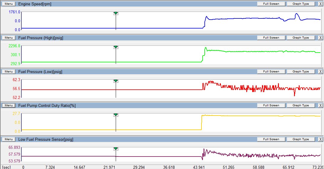

    it could very well also be injectors. To diagnose you'd need a scan tool again and this time you'd fire one injector with the engine off and watch the pressure drop then run the engine to clear the fuel from the cylinder and repeat for each one. The injector with the odd ball pressure drop would be the culprit. You could also do a resistance check on each injector but usually an injector will throw a code when the resistance is off. From here you need a scan tool for further diag. I haven't looked on the tacoma but most vehicles now don't have a fuel pressure test port for a manual gauge. Especially with direct injection engines, hence the need for a scan tool. Or alternatively you can do a power balance test which is to run the engine and cancel injectors one by one and look for an odd ball change in running when one is cancelled but usually a leaking injector will also manifest as a rough running situation. Especially at idle

    Techstream has all fuel, timing related PIDs. Fuel pressure high, low, pump duty, IG timing, etc. Have a proper diagnostic done by professionals. It is not hard to figure out what causing the issue if you have a proper tools
