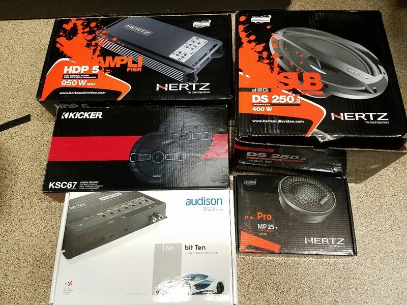

    Quick update, all components received and install has started :thumbsup:.
    I kept going back and forth on a sub and the rear door speakers, voices in head finally talked myself into spending just a few more dollars and sacrificing the passenger side storage. The sub will fill out the missing lower Hz (35-60 Hz) and prevent pushing the front woofers lower than 60 Hz. fergsonfire hit the nail on head, just a few dollars more relatively to raise the bar even higher given all the other components.
    I did take a look at the home speakers for the doors, in summary found some with really good acoustic specs and 3-4x cheaper than the branded "audio" bits as slowcomma pointed out. But the potential issue was all these drivers had a depth greater than 3" (7.6cm). I wasn't able to definitively confirm if they would fit, that is without first taking off panels and running the tape. So I stayed with the selected Hertz gear in the front cabin. I just added the hertz 10" sub and kicker 6.5" 2-way's for rear doors, this added another $272 in parts.
    let the fun begin, can't wait to turn the knob...
