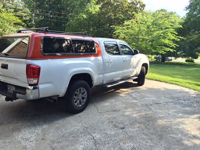

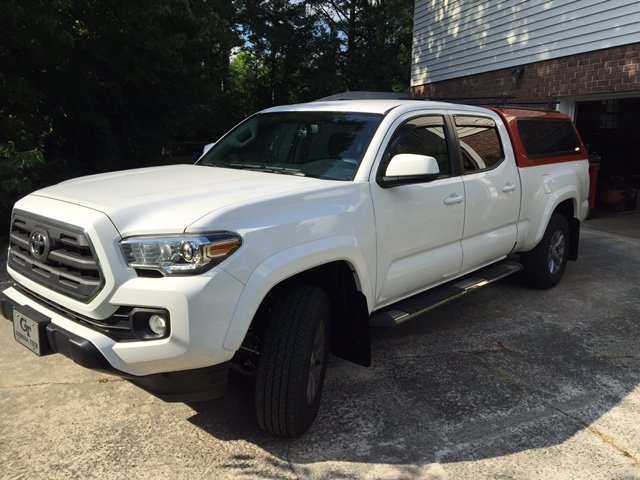

    Sure! I ordered Rally Armor MF20-BAS-BLK from AutoAnything, here's a direct link: http://www.autoanything.com/mud-flaps/77A9434A4072482.aspx Note the picture shows a red logo, the ones in the link actually have a blacked out logo, and are the same as the ones on my truck.
    These are 11.5 W x 19 L. I can't imagine having anything smaller, the ones on Amazon linked earlier can't give full coverage, especially if you're looking at bigger tires.

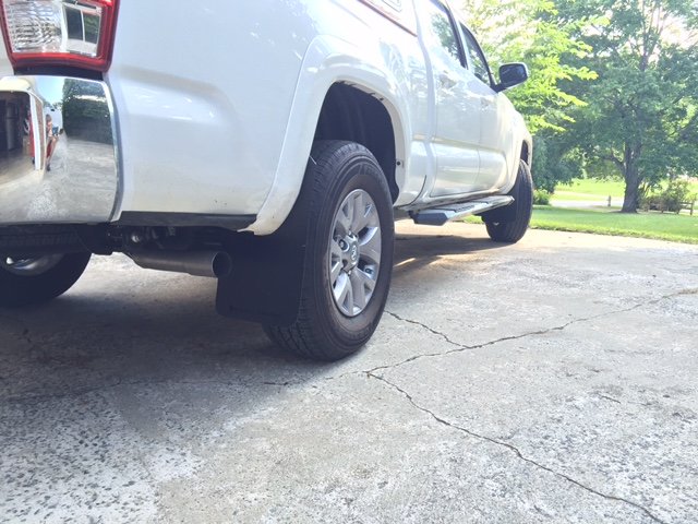

    Sorry for the terrible quality, cell phone pics. These still should help. General pictures:
    Again, they get GREAT coverage.
    They're a bit flexible, but still rigid enough to hold shape, so I think they'll hold up well enough offroad. I have a 5-day old infant and a 3-year old, so even though I have BFG KO2s and a Fox stage 3 kit in the garage, it'll be months until I can actually install them and offroad. Someone else will have to be the guinea pig there and report back. ;)

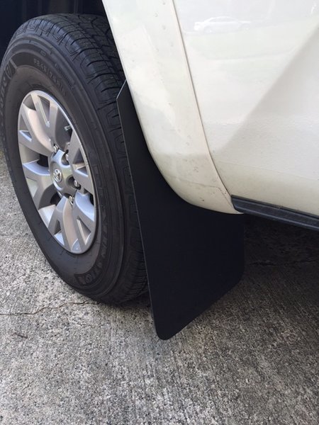

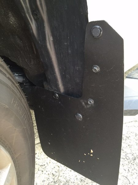

    Here's a close-up of the front driver's side flap:

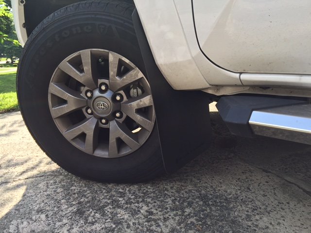

    Here's how it's mounted:
    You have to drill the holes yourself to get them in the right place, which is a bit difficult and took about an hour for me to do well. I propped the flaps up on a can to get a consistent height, then aligned them to perfectly vertical with a level on the outside edge, taped them in place, and pushed HARD against where the hex heads were, leaving an indent. Drill a tiny hole to verify, and if alignment is good, drill the right size hole. :thumbsup:
    I felt like the factory points were insufficient, so I drilled out holes in the wheel well for pop rivets and added them. https://www.amazon.com/gp/product/B00842A7F4 are the ones I had, they're left over from another project. Gloop some caulk in the void to seal it up from water intrusion.

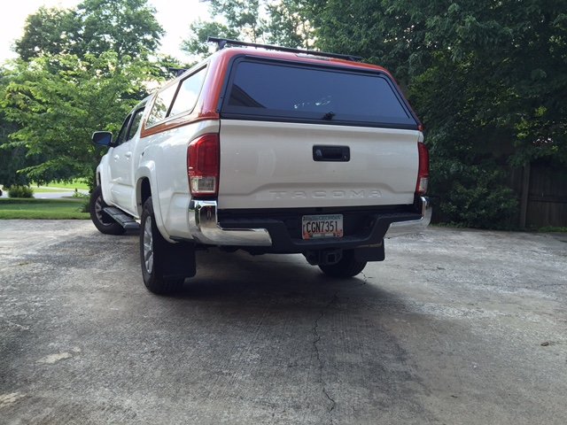

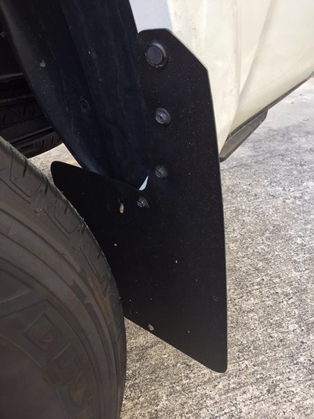

    Here's the rear:
    And mounts:
    The rear there's no real great place to mount one on the wheel well inner, so I just added one to the top.
    Hope that helps. :thumbsup:

    Hey there - I was just in the process of putting the Plasticolors on my rig. On the back, I just used the three factory fasteners (without any spacers); I guess I'll find out if they distort/warp or not. In the front, I was stumped, because the two obvious fasteners will definitely not be enough. What is your pictured third bolt connected to?
    Thanks!

    Stuart
    17 Tacoma TRD Sport ACLB MT
    It’s bolted to a small aluminum L bracket that bolted or zip tied into a hole on the underside of the cab mount. It worked well.

    Thanks, this prompted me to look underneath. There's an upward-facing bolt that holds the fender trim in place. I used some license plate scrap to make a little bracket and attached the flap to it with the self-tapping screws that were in the package. A lot of eyeballing and fiddling but easy, and looks pretty secure.

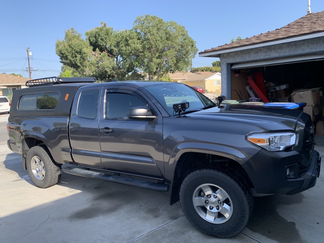

    J
    2018
    My sr without fender flares with oem mud guards for tacomas with fender flares. No fitment issue0D5E480F-D58E-4FA0-B897-BB7D90A5D392.jpg
