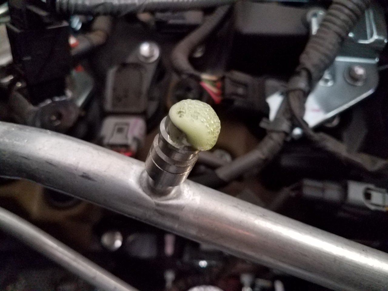

    It's finally hitting the bottom-end of the top-end of temperatures here in Phoenix. Noticed today while out running errands that the AC could absolutely not keep up with cabin cooling. Air coming out of the vents, on Recirc, was moderately cool, worse than I experienced before. At time of travel, ambient temp was about 109F. With the current issues I'm facing with a "clacking/knocking" AC compressor, I decided to nose around under the hood. I'm quite familiar with R-12, R-22 (residential old school), and R-134a systems. I'm not an HVAC guy, but I do know enough to check pressures and do high-level diagnoses. An AC cooling system not blowing cold air is indicative of a problem, and it's usually low refrigerant.
    Started up the truck, took a temp-check in the garage (105F), and proceeded to hook up the gauges. After taking off the cap of the low-pressure pipe, I immediately was presented with the frothy mess in the picture! Not only does that mean there is a lot of seepage through the Schrader valve, I have never seen something like that. I couldn't get my R-134a quick-connect to work, so I peeped up to the hood: R-1234yf? WTF is that? When did that happen? [Steps out and looks online. Watches a couple videos. Ah, I see...] So with respect to what I suspect is yet another tweak to cooling systems that undoubtedly make it worse and/or less efficient, is the frothy mess normal?* [See side rant.] But it all seriousness, if that crap is flowing through the AC system, then how can the orifice work properly? It just appeared to be a thick stew of oil, leak-seal, and dye!
    * Side Rant: We all know that R-12 was the best! But alas, the ozone! OK, no problem, I do appreciate the EPA and the environment. R-134a...not as good, less cooling, but still pretty good. Now R-1234yf? Seems terrible.
    If anyone know for sure, or wishes to check their own 3rd gen, then let me know. If so, then to me, this is looking like an immediate trip to the dealer for inspection.

    You definitely have a leak but your not seeing dye. Toyota doesnt use die in their systems. Blow out the port and mix up a little dish soap with water. Spyay in the port and see if there arecany bubbles.

    Are u sure this isn't from trying to fit a 134 adapter on a 1234yf Schrader? Fwiw my Chevy Schrader had that same issue. I reached in and pulled up on the valve and it temporary got me by till I fixed it for real.

    I will do that. I'm hoping it was just residual oil from when they filled it at the assembly line, because after seeing that I immediately suspected that the entire system is super-saturated with oil.
    Here's the thing: I haven't really come across any vehicle that doesn't emit some amount of pressure, i.e. slight, quick "hiss," upon unscrewing the valve caps on either the high-pressure or low-pressure ports. I just chalked it up to it's just the way it is. After all, the caps do indeed have good seals, and the slight leak is contained in the capped valve. However, I have never experienced a bubbling and frothing mess like that before. Very strange.
    Nope. That mess came out of the port immediately after unscrewing the cap. Also, apparently the low-pressure port of an R-1234yf system is bigger than on R-134a systems. So the adapter just bumped the top and did not clip over. Therefore, I suspect by the year 2100, the R-123456789wtf system will have a LP port the diameter of a toilet bowl!
