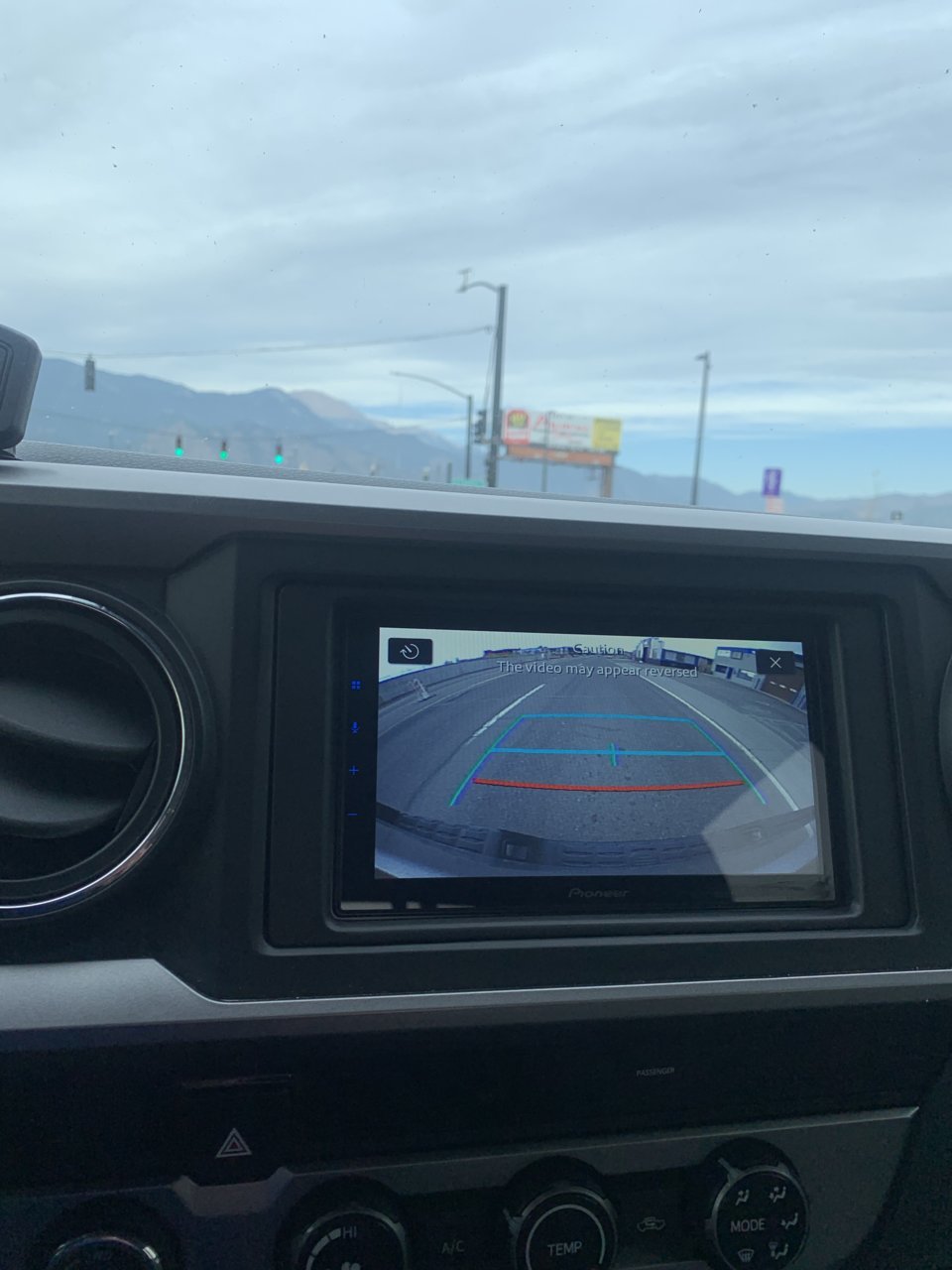

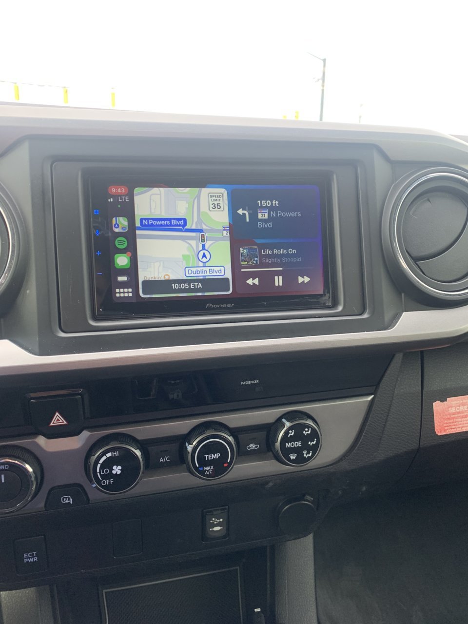

    New stereo install. I really just wanted carplay, but pioneer HU's are legit. Pictures and details below.
    Stereo Installation experience: None
    Truck: 2017 Tacoma SR5
    OG Stereo: Non JBL
    New Stereo: Pioneer DMH-W4660NEX
    Install time: 3.5 hours
    Adapters:
    Dash: American International TOYK9714 Dash Kit
    Aux: Crutchfield RCA Adapter
    Radio Antenna: Metra 40-LX11 Antenna Adapter
    USB: Metra AX-TOYUSB USB Port Cable
    Interface: iDatalink Maestro RR Interface Module
    Interface Harness: iDatalink HRN-RR-TO2 Factory Integration Adapter
    Total: $840.99
    Not cheap, but crutchfield does a great job putting these kits together. The only thing they dont include is wire connectors. I opted to solder/heat shrink mine. I did this with zero soldering experience and everything worked immediately. Hope this helps someone out!
