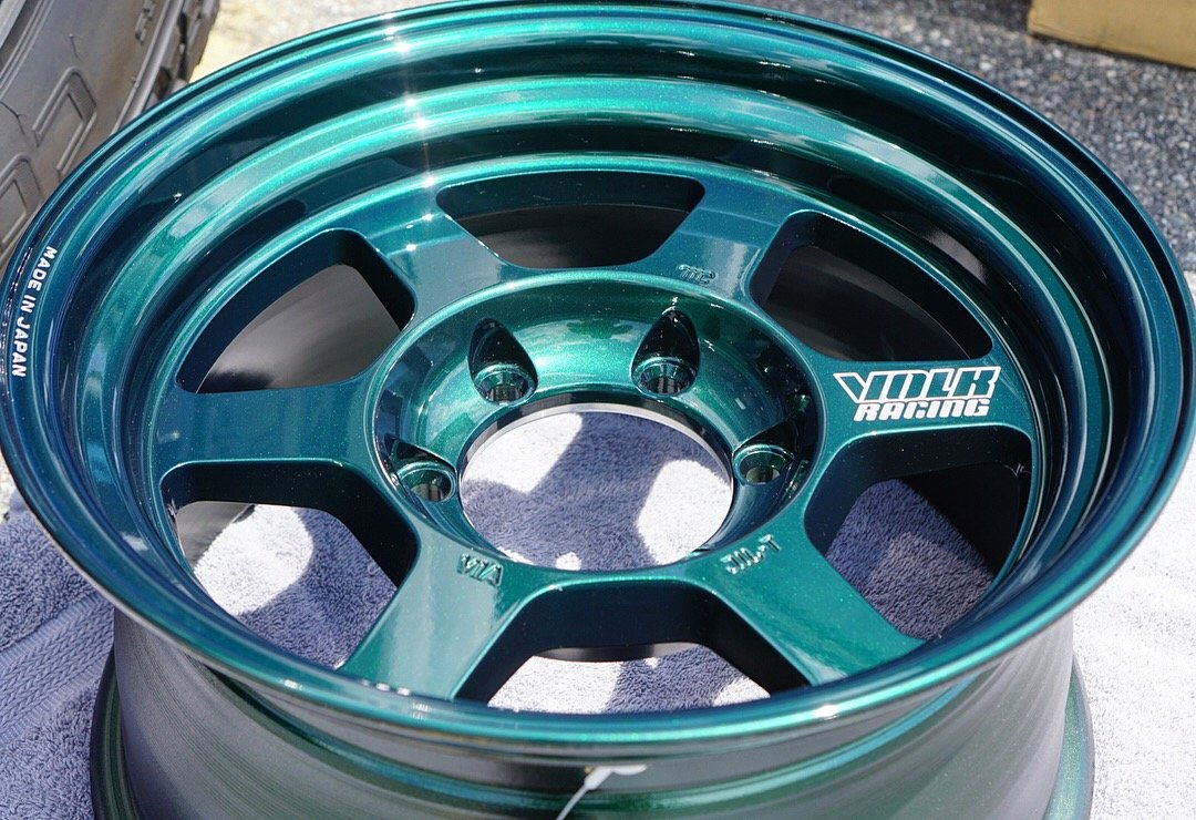

    Reliable auto detailing did my coating, owners name is Terrance.
    Another person Willie he owns washmepleaze. This is him https://youtu.be/r6yKDUPlcQk
    Both have IGs. Willie is more on the high end spectrum on cars like lambos etc. Terrance is more of the daily driver vehicle, but he can do high end cars. Both places wash, clay bar, chemical decon, paint correct, level your paint etc etc bedore laying down the coating.
    Terence coating my wheels not to long ago as well. B1FB914D-60C6-4BCD-86A4-4413EE2E3F35.jpg

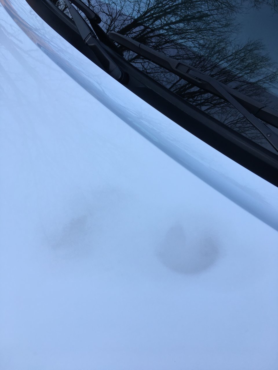

  14. Feb 3, 2019 at 1:10 AM
    #94
    Mike5150
    Mike5150 New Member
    Oct 24, 2010
    #45175
    3
    Virginia
    2017 Tacoma TRD
    It appears my 2017 has developed the same problem. I noticed back in the fall when I waxed it that there was a dull area but after cleaning it today that area has become darker and bigger.upload_2019-2-3_4-10-36.jpg

  15. Mar 30, 2019 at 8:54 AM
    #95
    Saras
    Saras Active Member
    Feb 4, 2017
    #209612
    33
    2017 White TRD OR
    Hi, Having same issue on the hood and the roof. Went to dealership and service manager told to come back when Toyota representative is there. He comes once and month and they will call me to when to bring it back. They did not take any pictures to record this incident and told that they never seen any tacos with paint issue. Had only 2010 Rav4 with peeling fender and older 4Runner. Will have to change my schedule just to meet suit that shows up randomly once a month... I had 2002 Civic (sold 2008) and mom's 2010 Versa (sold 2017) both white and at that age cars had mate looking finish. Was able to polish them and came out like new. It is definitely paint problem with white tacos. These spots should not develop on two year old vehicles. Will update soon.

  16. Apr 24, 2019 at 3:07 AM
    #96
    Saras
    Saras Active Member
    Feb 4, 2017
    #209612
    33
    2017 White TRD OR
    Toyota corporate rep looked and measured paint of my car and agreed to repaint hood and roof. I took it to body shop that they deal with and estimator will sent estimate directly to them. Asked what is the price tag for that type of work and she said 3000-4000$ They have to remove windshield, rear window and roof racks. Also they will provide warranty as long as I own it. Now I just have to wait for shop and dealer to finalize their process and they will let me know when to drop it of and pick up a loaner.
  17. Jun 8, 2019 at 4:40 AM
    #97
    Saras
    Saras Active Member
    Feb 4, 2017
    #209612
    33
    2017 White TRD OR
    On Monday I dropped of my truck at the dealer to get painted. Got new Camry as a loaner. Truck was done on Wednesday. Paint job looks ok so far. Problem resolved. The bill was 1600$ FROM the shop.
