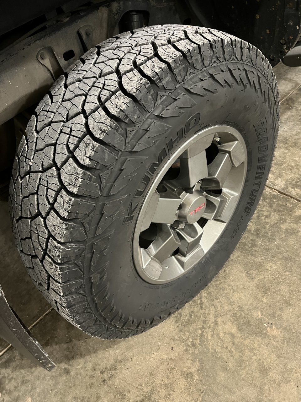

    Are those the right size tires for your Taco?
  2. Mar 4, 2023 at 8:40 PM
    #42
    Ronk44
    Ronk44 Well-Known Member
    Jan 6, 2020
    #315332
    639
    Rockerville, SD
    2017 MGM Sport
    Leveled with Bilstein 5100 shocks, Falken Rubitrek AT 265/75 tires, Redline hood struts, R4T tailgate lock, Matt Gecko LED strips in bed and under hood, WeatherTech hood guard, OEM bed mat, Husky floor mats, Carhart seat covers, Grille replacement with Toyota letters, Sony AX6000 head unit, OTT lite/mild tune, and an occasional splash of fuel additive.
    Not factory, one size up. Truck originally had 17s. Rims came off of FJ Cruiser and are 16s1E51FEAC-FA73-4057-8585-01C6BC219E88.jpg

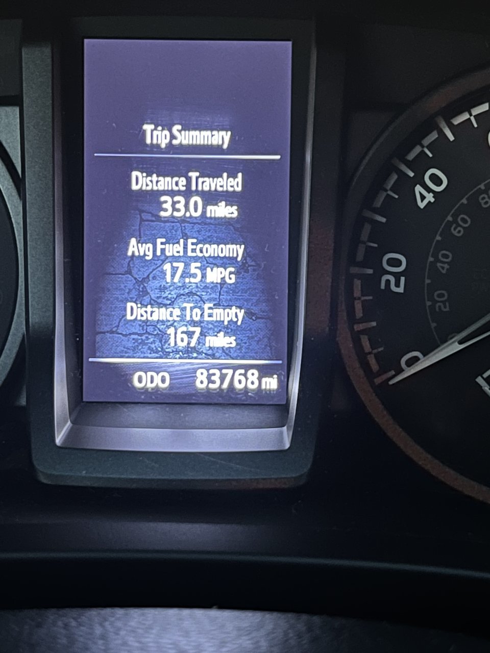

    I have a trd OR 4x4 longbed with a gfc camper, c4 hybrid bumper with winch and sliders, and kings all around, with a magnuson supercharger, on 265/75r16s wildpeaks and im getting 17.5mpg averaging 70mph on the freeway. Forgot to add since i do have it boosted i can only run 93 octane.
  13. Mar 7, 2023 at 9:22 AM
    #53
    medicfung
    medicfung Well-Known Member
    Nov 21, 2018
    #273365
    1,030
    richie
    2019 DC TRD OFFROAD 4x4 6ft bed quicksand
    This is from my commute this am to work
