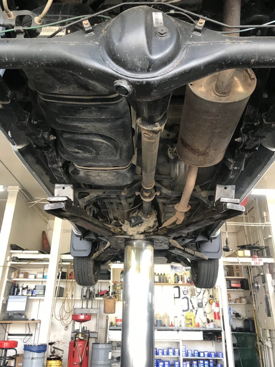

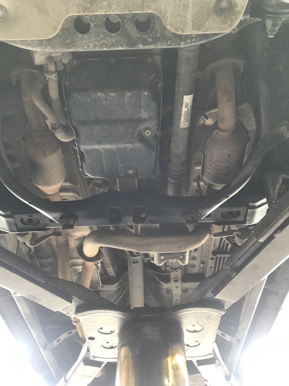

    Normal amount of rust, just hit everything except the exhaust with fluid film, i used 6 large cans and that's it!

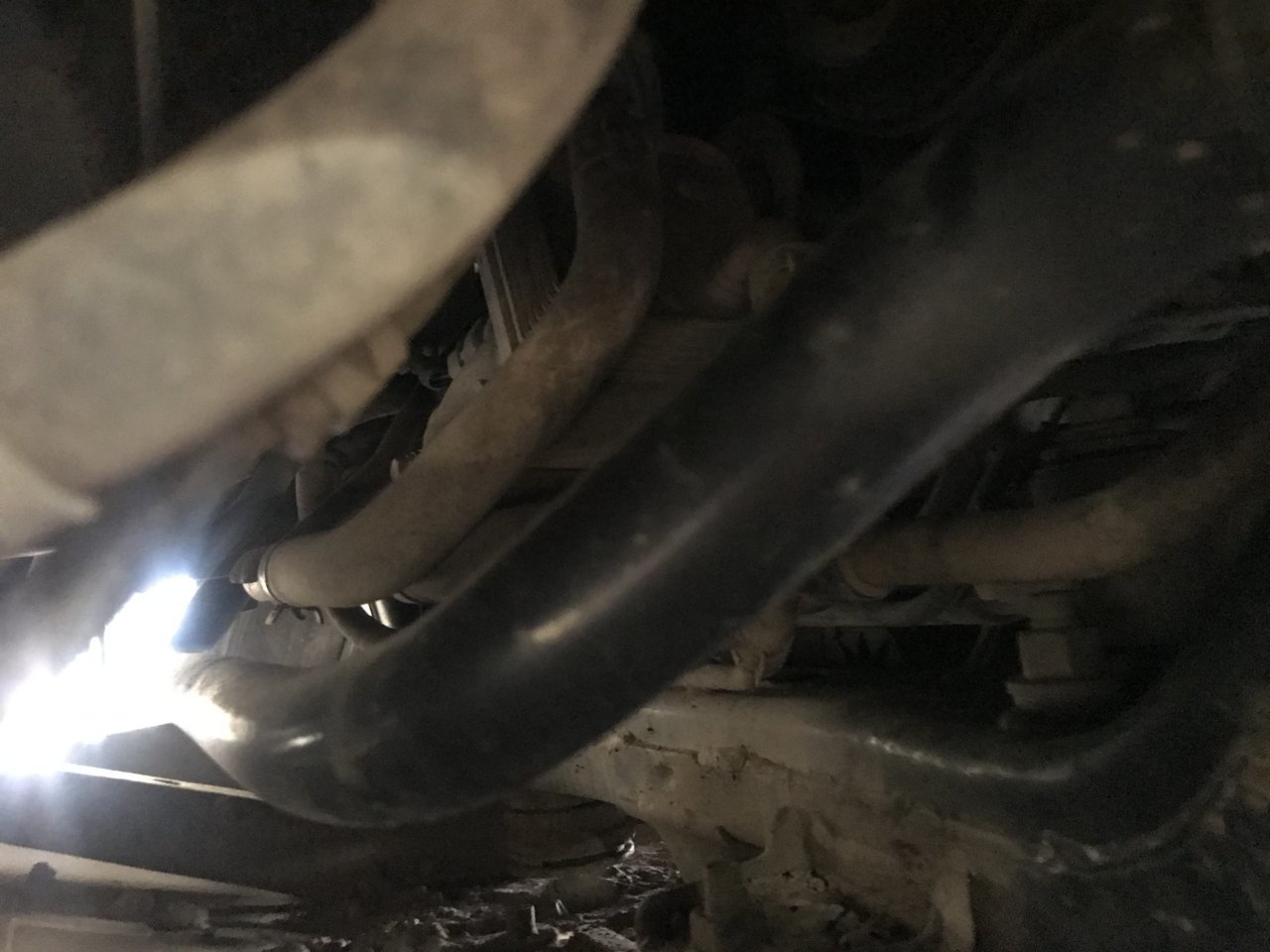

    Wheres the rust?

    What oil stains?
    You aren't talking about the black-colored skid that hooks onto two bolts?

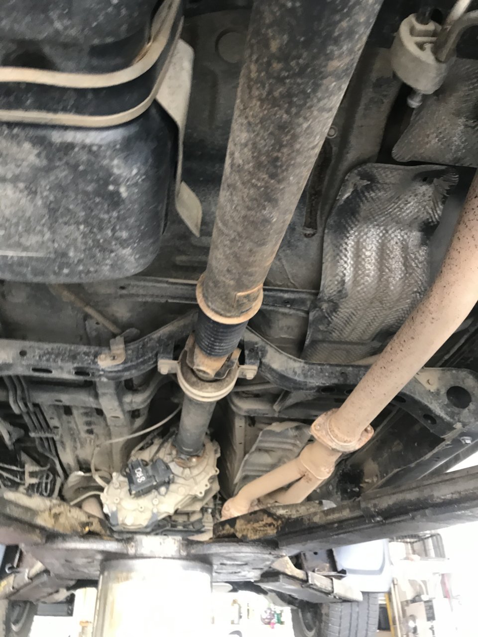

    The truck appears to have waded through water higher than the doorsills, as evidenced by the bent debris guard forward edge on the fuel tank (next to the driveshaft slip joint). That on its own isn't a cause for rejection, but inspect the carpets for water ingress.
    It's a common mod to trim the bent portion with sheetmetal snips so it doesn't rub on the driveshaft.

    Yeah looks uniform to me. Seems like it’s metal, not oil?

    Looks like mine last year. FYI I noticed spot rust on the welds when I was installing my sliders. In AZ not that big if deal

    Nothing I wouldn't expect from a vehicle that old. Mine looks like that too. I plan to start using Fluid Film before the winter, which will inhibit the current rust too. Just avoid rubberized coating like the plague. The dealerships tend to use that for their "rust protection" that they offer.

    Depends on where the truck lived,whether it was maintained properly,etc. that truck is already 3 years old,so normal I would say.
