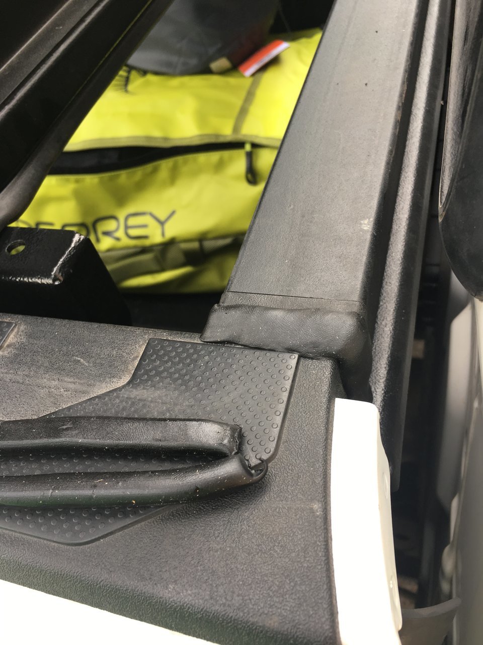

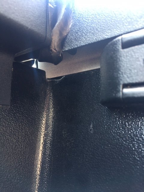

    Hello,
    So I recently bought a 2017 Tacoma sport to replace my 98 Tacoma. I had a new leer shell installed and we discovered that the two front bed rails have a 1" gap between the cab rail and side rails. So this is still exposed when the shell is installed. The installers used urethane and silicone which did not work it still leaks. Has anyone encountered this issue, and has anyone solved this issue yet? Thanks guys!!IMG_2516.jpg IMG_2515.jpg

    Neoprene Foam tape/foam strip slightly thicker than the gap wedged in there? And maybe for overkill some silicone over the foam?

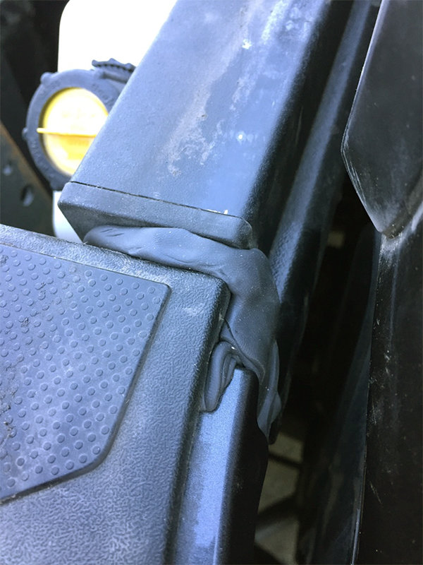

    Did the same thing... except your butyl work is much better than my butyl work. I'll put a couple more layers above the top before I set the canopy back on.

    Yessir. Butyl worked good! (Plugs did not work.) Not the prettiest solution, but it works well!

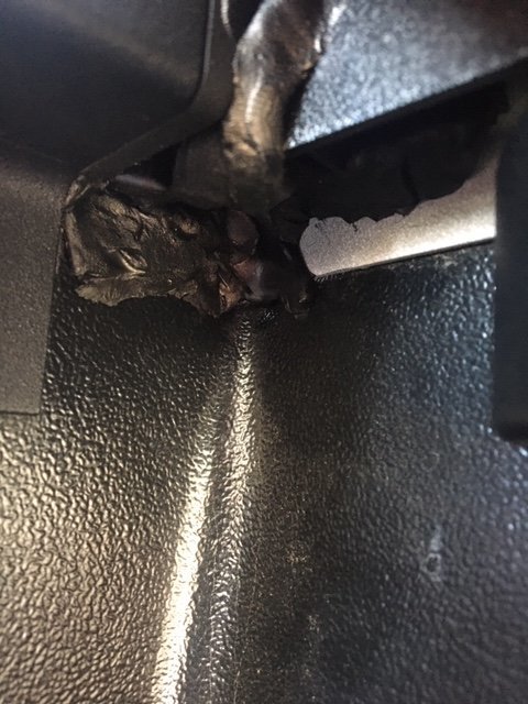

    I followed the suggestions and used buytl rubber. I added additional rubber to the corners from inside the shell as ther was still some leakage from the suggested fix. By forming some extra rubber in my hands and stuffing it into the corners directly under the head rail I was able to some all the leaking. Sorry I don’t have any pictures.

    The only source of leaking was in the front corners' gaps. No leaking from the side rails. I used foam adhesive for the sides and front. Butyl for the front corner gaps.

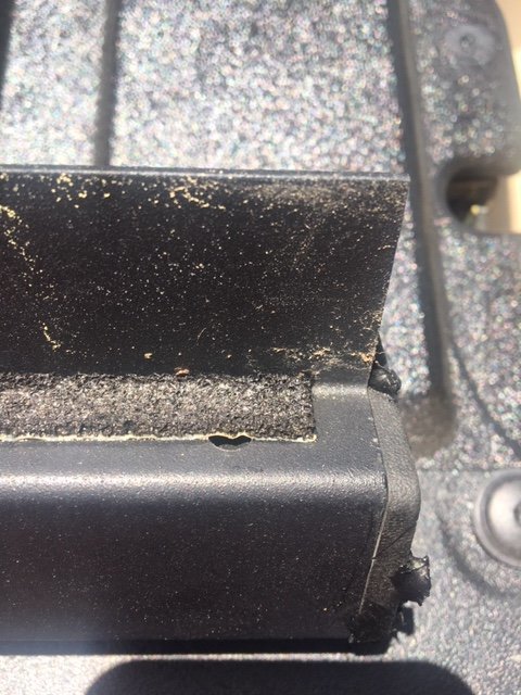

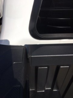

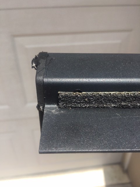

    So I worked most of the day on the "seal as much as I can project" on the bed. Here is what I used. I have the diamondback SE cover. Did I ever learn a thing or two today!! So I used the butyl tape shown below. Yes it worked. I sealed the gaps. Then painted the top with black paint so it wouldn't stick to my cover's seal.
    Then I noticed I still had large gaps where the rails met so I went under the bed and pressed butyl rope into the gaps (pretty easy to work into the various spots) and thought I had it sealed.image3.jpg image4.jpg
    Since it was going to rain in about 15 minutes I closed the cover and waited. Thunderstorm and rained hard with wind. Opened the cover when it was over only to find water on the tops of the wheel wells again. Upon investigation I noticed it looked like now it was coming from underneath the corner of the bulkhead. Decided to remove the front bulkhead and realized that yes it does have a felt strip underneath (read tiny very porous strip) that doesn't even go all the way to the end.
    Decided to install the bulkhead strip diamondback sent me (yeah I should have done this first I know). I then reworked the butyl rope back into the gaps. Waiting on the next thunderstorm now.
