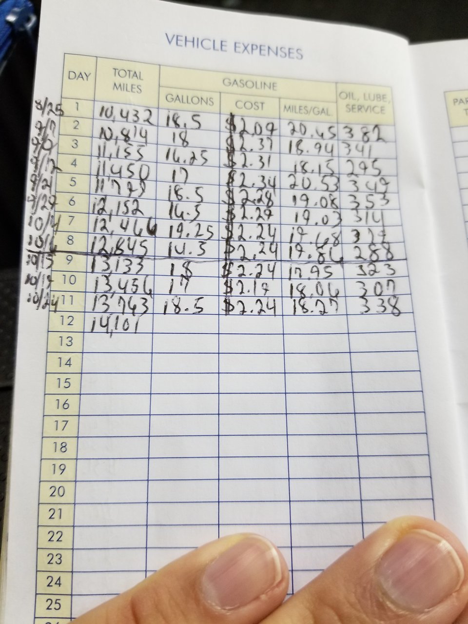

    First 3 fill ups after the new tires. Seems pretty steady at around 18mpg with 1/3 city and 2/3 on each full tank.

    Thanks so much for following up. Are you doing any kind of adjustment for tire size when you calculate the MPG?

    Just a hand calculation based on miles traveled and gas put into the truck. I track the miles on the odometer from last file up to current fill up. I stop pumping at the nearest quarter gallon after the first gas pump fill up pump stop.

    With the tire size change, it should be a little better. You can divide the miles traveled by 0.966509 which would account for the difference in going from a 30.59" tire to a 31.65" tire. This will bring your MPG up a bit. Looks great to me.

    Oh didn't think of that. Good call.
