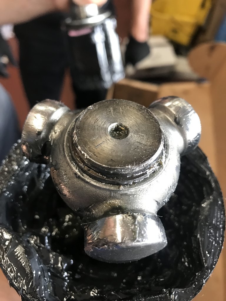

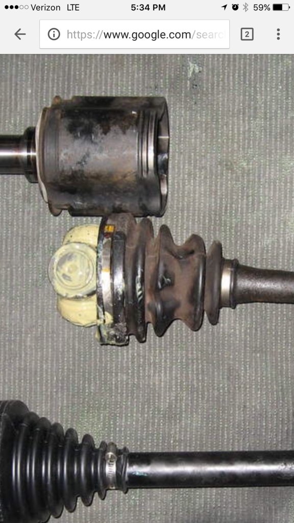

    What am I looking at and what should it look like?
    I would like to be shocked and appalled by this.
  11. Jul 25, 2017 at 5:36 PM
    #31
    kefferjoe
    kefferjoe [OP] Active Member
    Jul 24, 2017
    #224927
    31
    Joseph
    2017 Tacoma TRD Off Road
    OME BP-51 coilovers lift kit
    See how this assembly has bearings over the knuckles. I'm missing all of those.
    TacoRD16 likes this.
  12. Jul 25, 2017 at 5:38 PM
    #32
    tacoflavoredkisses1
    tacoflavoredkisses1 Well-Known Member
    Apr 10, 2016
    #183838
    2,564
    16 TRDOR DCSB (SOLD)
    lol
    In that case, I am appalled.

  16. Jul 25, 2017 at 11:18 PM
    #36
    GPsevinSixx
    GPsevinSixx Well-Known Member
    Aug 15, 2016
    #194631
    3,021
    Ros Angerus
    2015twoAX2.4techPAWS
    6112/5160AALfnCNTSTRyokG015
    Missing tripot bearings from the factory!?? WTF Toyota?
