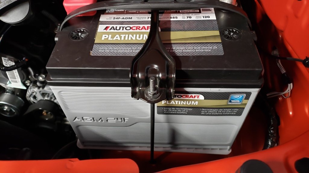

    Mine crapped out at 9,000 miles. Bought a good battery from Advance Auto and got reimbursed from Toyota under the emergency repair warranty clause. Much better than getting the same crappy battery installed at dealership.
  5. Jul 8, 2019 at 11:48 AM
    #45
    Wengel21
    Wengel21 Well-Known Member
    Jun 6, 2017
    #220898
    347
    Ben
    SoCal
    2017 DC LB TRD OR
    Does that say "AutoCrap"?

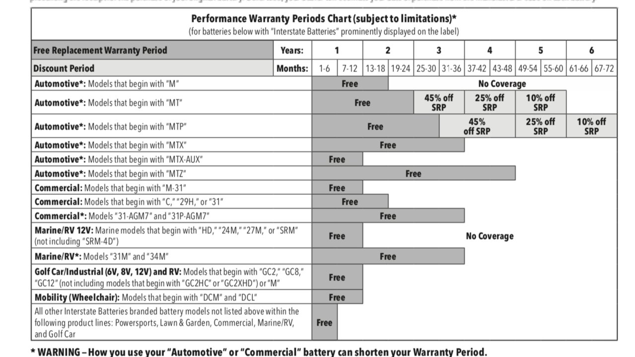

    Crossed over 36k Friday...Saturday morning dead battery.
    Pro tip that I learned, buy an Interstate from Costco with a 42 month warranty
    You can take it back and exchange it anytime before then no questions asked.
    I’ve got a reminder set on my phone to return my battery 41 months from now.

    It is a pro-rated warranty.
