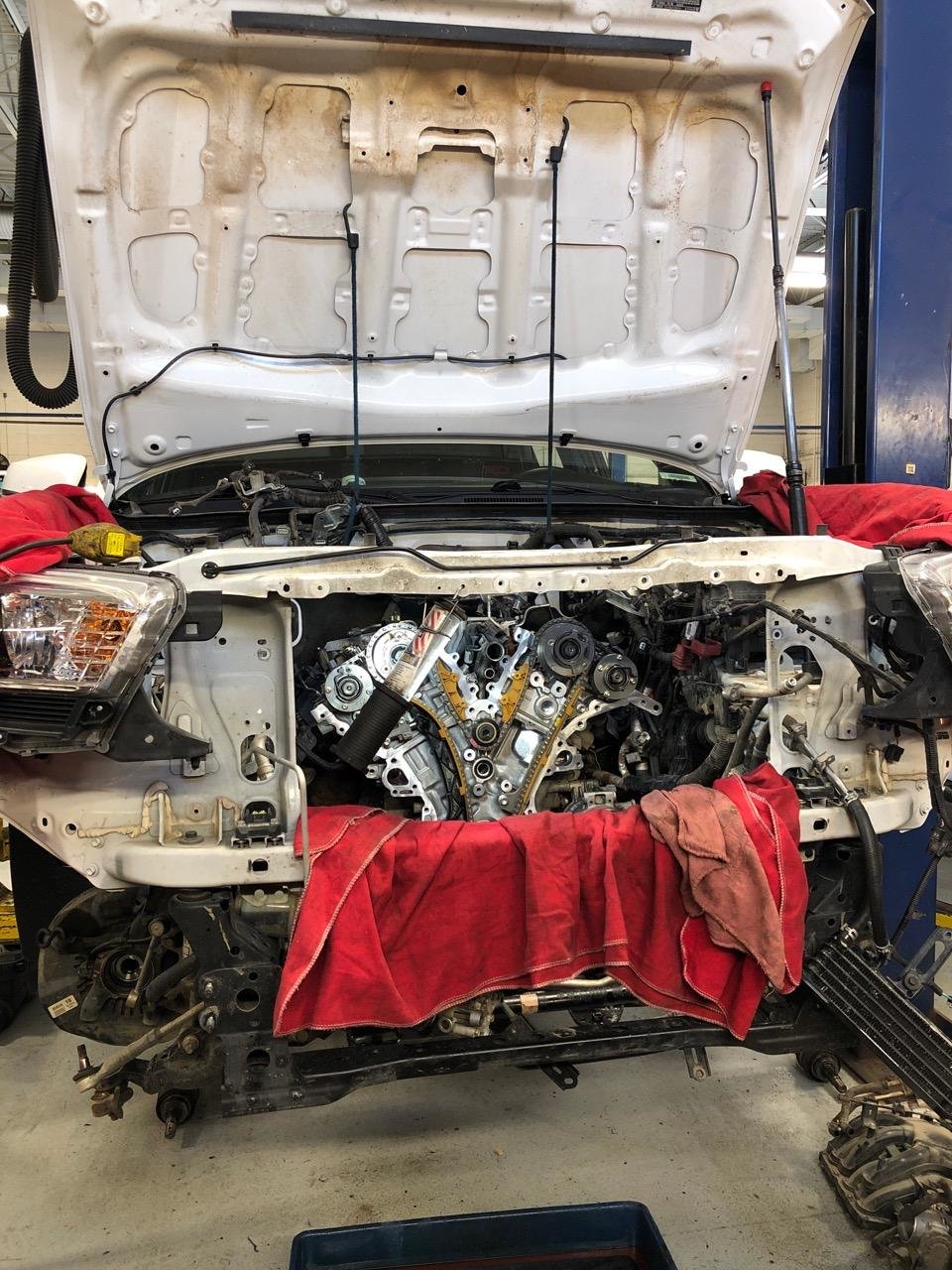

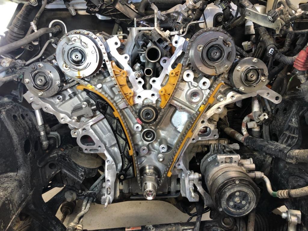

    It is a big job. Either the engine and transmission must come out or they take apart the whole front end. I just had mine done here recently on a 2018 Tacoma TRD Offroad DCLB with 50,000. It is a known problem in the 3rd Generation Tacomas and well documented. Luckily, it was covered by warranty. Otherwise I would have also thought about punting it down the road.

    @Madmax134 it sure does look like a big job. I see how they choose to get at yours. Probably that is the fastest way. Still if that's $4k it's good warranty covered it. Most people would not be cool so with that while making payments on the vehicle.

    i watched alot of youtube fix videos of ford trucks 4.6 / 5.4 when shopping for a used truck and that picture reminds me of the crap they had to go through to fix common issues with cam phasers and plastic timing guides. Nice to see the same shit in the toyota.

    That is incredibly clean for 50k. No varnish to be found, guides look good; what is your OCI?

    Wonder how much a rebuild is ?

    Need some gas struts too Tall ones:D that prop hold up the hood looks might sketchy

    Or you can do it yourself for the cost of the gasket and your time. Its a timing cover gasket for God's sakes. Screws, scrape, gasket sealant, gasket, same screws, tighten. Done. Do the timing chain and water pump while your down there.
