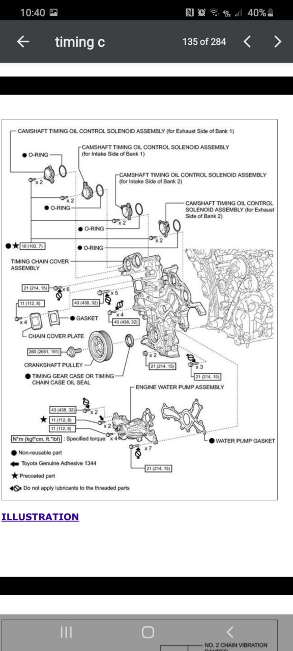

    So I was just scrolling through the service manual and just figured I'd look into removing the timing chain cover. I mean its definitely technical and will take some time but definitely do able if you have the time and tools and space to do it in and will save you alotttt of $ if you do yourself. Including pics just for fun. Screenshot_20200801-104011_Drive.jpg
