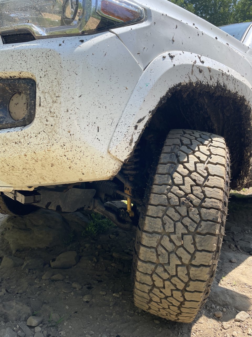

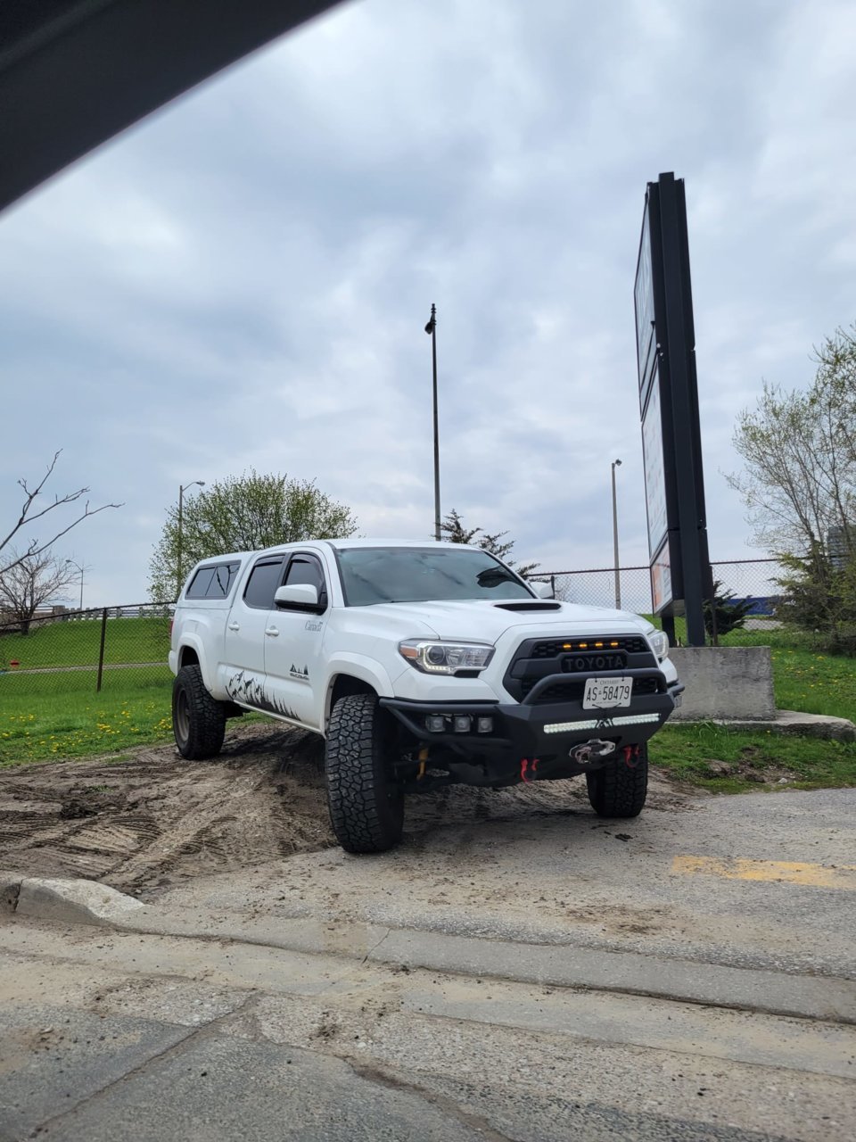

    Slowly building my beast… still rubbing going to do a body mount relocation next, without running 1.5 spacer no rubbing but now that I’m running the spacers there is rubbing

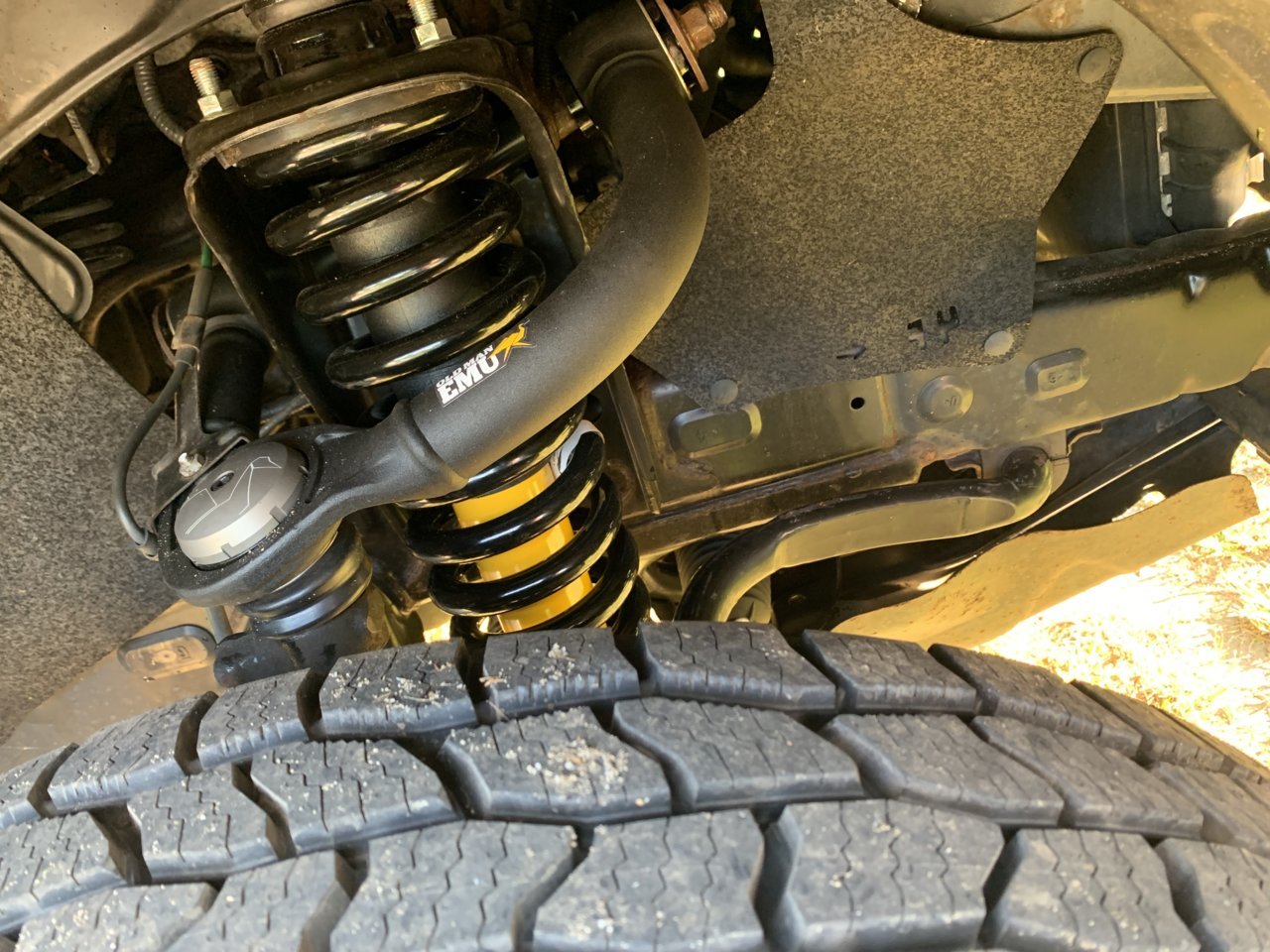

    I have OME 886/Dakar HD on my '21 TRD OR, aftermarket bumpers front and rear, winch, and full skids. I have 2.5" lift in the front 3" in the rear and carry a lot of weight of work tools and recovery gear.
    You won't need UCA's with that amount of lift.
    I run stock 16" rims with 235/85-16.

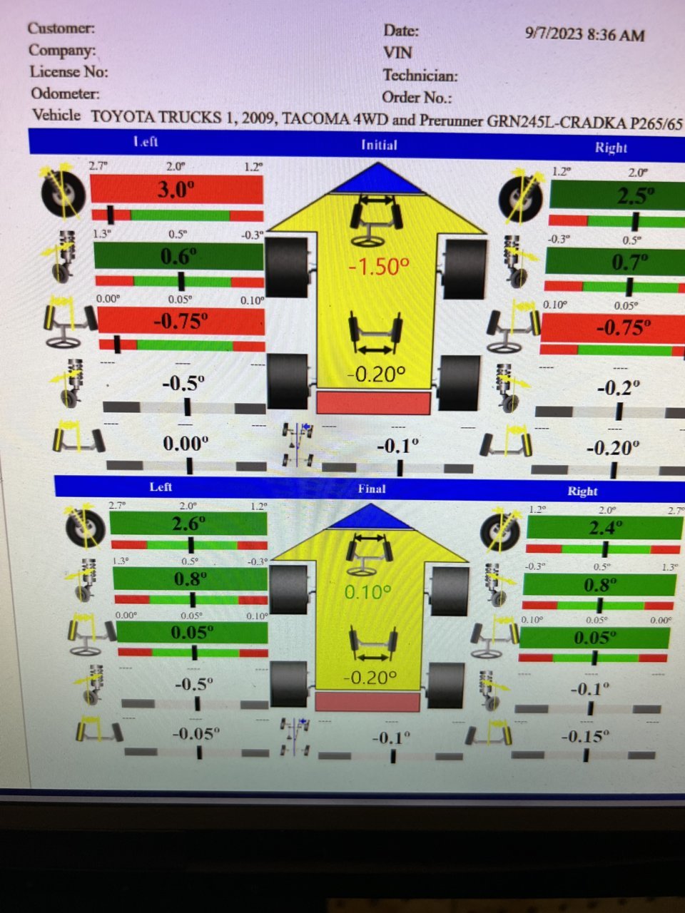

    Hi! I currently run 285 75 r17 I had to cut my body mount and now thinking about doing a relocation kit and a cut the inside wheel and high clearance fender liners because I still have some rubbing if I take a sharp turn off-roading
    Im running on ome upper control arm to adjust my camber helped a lot when you do a proper alignment I’m really happy with the current set up because it work as a daily but I do have a few upgrades in mind.

    OME2.5lift w/medium leafs
    ya , I got the ome 2.5 lift w UCA’s - it aligned mint . I figured, why not? Had to take the uca apart at the ball joint anyway, good time to do it

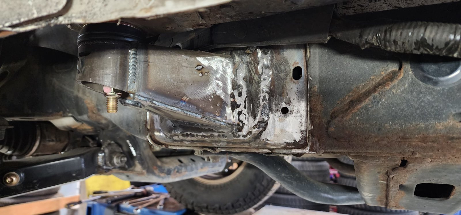

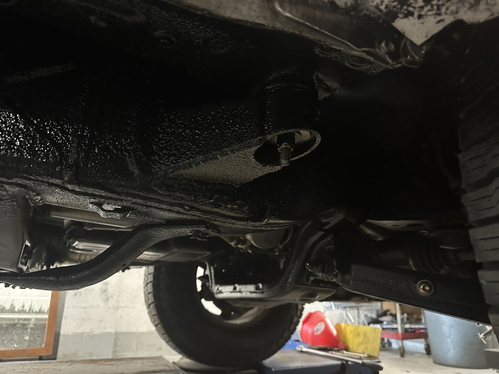

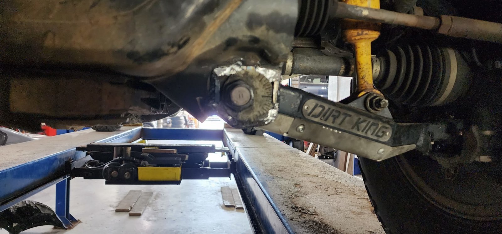

    hello everyone!

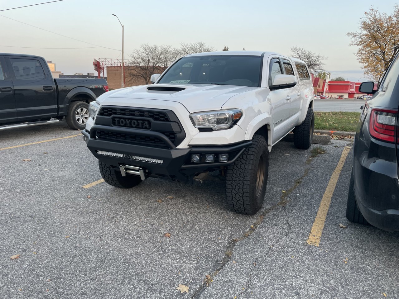

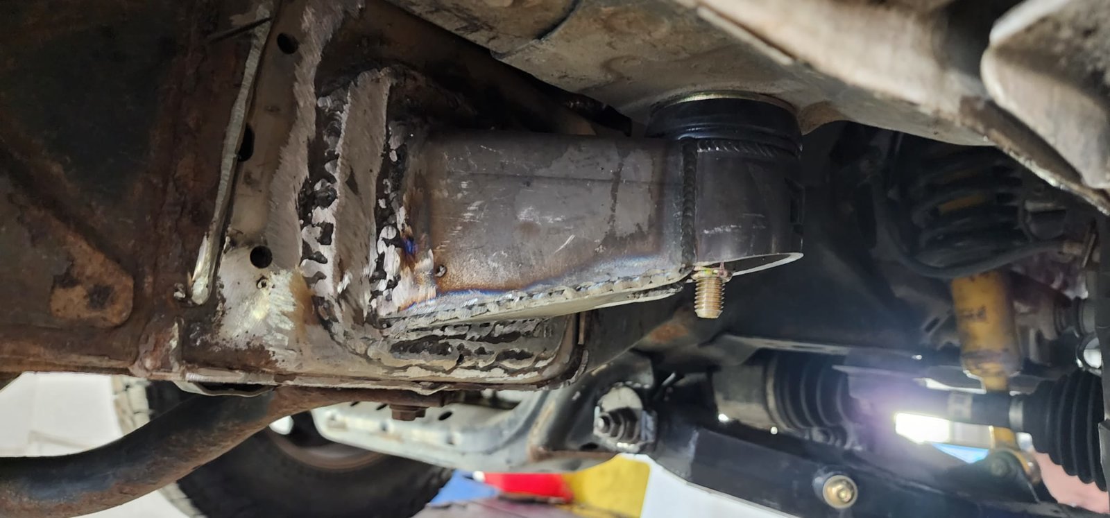

    abit of an update on the build, got the dirt king cam bolt gusset and a body mount relocation installed.
