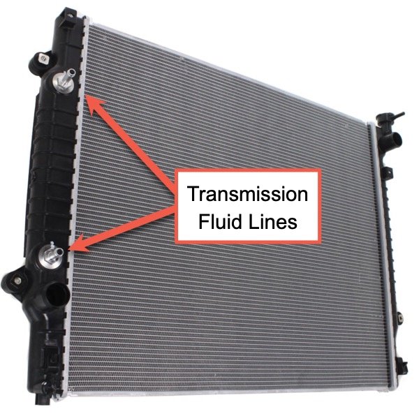

    OP's 2017 has an external tranny cooler (if equipped with tow package). Fluids don't mix.
    And I don't see how compromised oil cooler assembly could force the oil into cooler lines

    As mentioned, the Tundras had the same set-up, trans fluid went through the radiator whether they had a trans cooler or not. Not sure if it's the same with the Tacos though. More here:
    https://repairpal.com/pink-coolant-in-reservoir-and-transmission-slipping-594
    TW thread on it here but the OP references a T4R:
    https://www.tacomaworld.com/threads...-should-you-be-200k-radiator-teardown.742277/

    Photo of a replacement radiator for all 2017 Tacos showing the transmission fluid I/O lines. Our 2020 has the tow package with the external cooler (in front of the radiator) and the trans fluid I/O lines pass through it as well as these I/Os in the radiator itself. Although the Tundra's I/O lines were located at the bottom, it looks like the Taco's have the same setup. Not saying that a radiator transmission line failure is the OP's issue, but that pink milkshake sample looks exactly like the Tundra's experience. The repair involved replacing the radiator, flushing the cooling system and completely flushing the transmission - sometimes both more than once.

    Double check the transmission lines and the fluid level. Also you should get a compression test to make sure you didn't pop a head gasket
