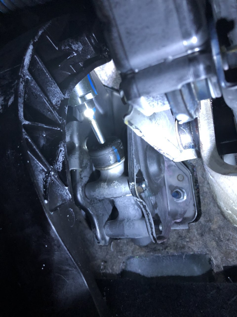

    749DE5A9-9A50-4C0E-9D01-2441036EE7A4.jpg dentedporsche, I am not clear about where to apply the grease. Here’s a pic of the plunger I am looking at, not sure where to apply the grease! Please clarify with your pic. Thanks......

    The rod with the hex nut end goes into that black cup. There is just enough slop to pull the rod down and dab some grease on a small screw driver or small stirring stick in the cup
