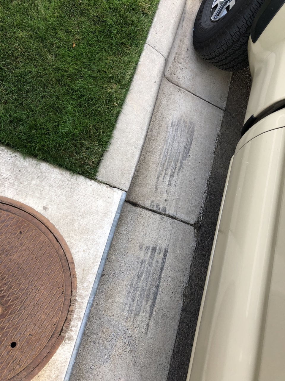

    I had a similar issue with the passenger rear drum locking up. Washed the pickup the previous day. It was in the 80’s or so and probably got into the low 50’s overnight. Jumped in the pickup the next morning and it wouldn’t budge. Felt like ebrake was on or someone jammed my wheels (I park on the street). I went through P, R, & D a number of times and set and released the ebrake. Nothing seemed to work. Dumbfounded, I turned it off and started again putting pressure on the gas pedal. Left some rubber on the road. Turned off again and waited a couple minutes contemplating calling a tow truck. Started again and it was fine. Like nothing had happened. So odd. No warning lights. It has been totally fine since.

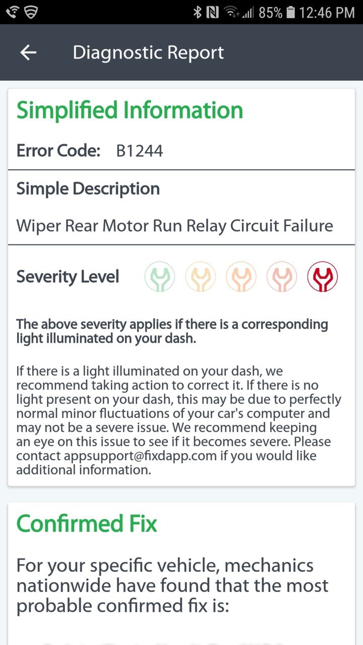

    This same thing just happened to me right now. Washed my truck last night, and when I tried to move it this moving, nothing. I did notice that after washing my truck and putting it in reverse to park, that the brakes felt a little tight, as if they were being applied. I ran a diagnostic on it, and it is giving me an error code of B1244.

    I read up on this issue, and supposedly it has to do with condensation entering the ABS fuses. I removed both of the 50 & 30 ABS fuses, and turned on the truck and moved it back and forth with no problems. Obviously the ABS warning light turned on. Reconnected the fuses, and no problems afterward. You can take it to the dealer to find out what the underlying problem is, or just carry a pair of needle nose pliers with you to remove the fuses.
