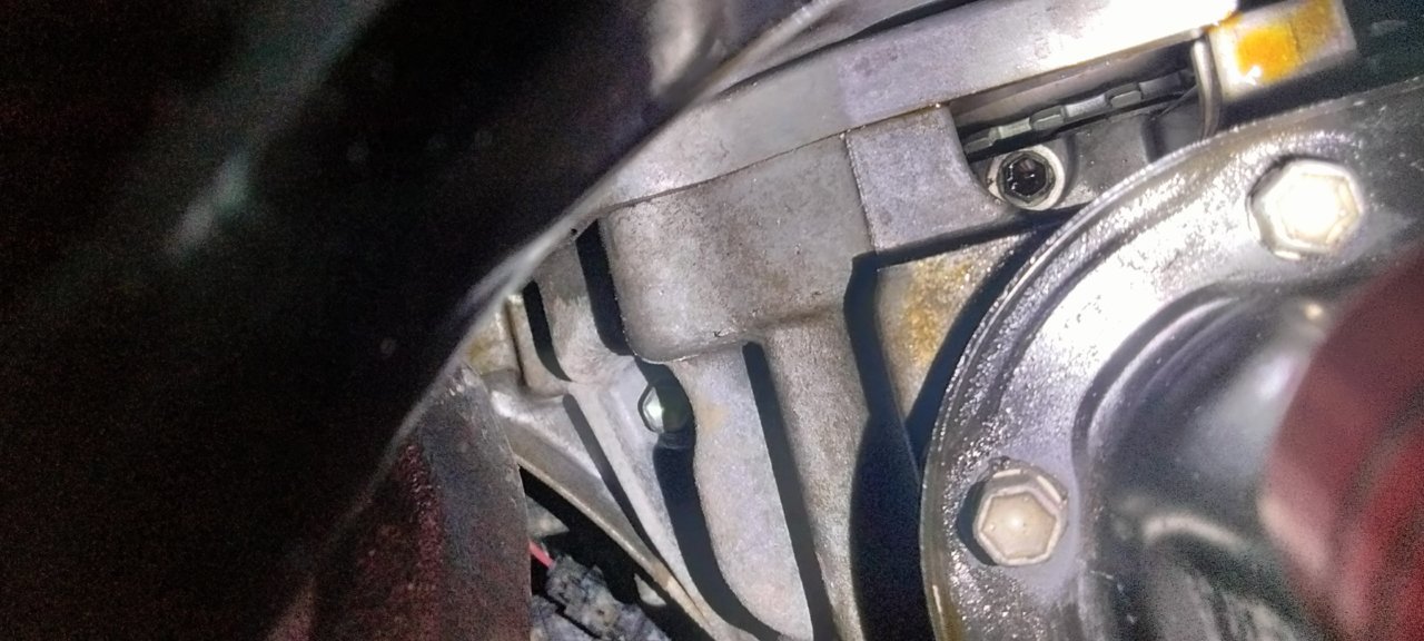

    It's dripping pretty good just went out there this morning and wiped everything down started the truck and it's definitely coming from that hole where the flywheel is and the transmission as far as I know oil should not be getting back there the only way I can get back there is past the main sealIMG20221113064016.jpg

    Looks like rear main doesn’t it…I hate that for you brother

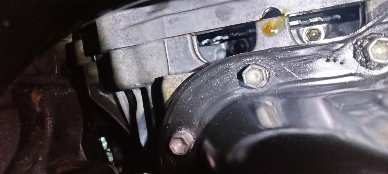

    bulalo likes this.

    I'm almost certain it is .I'm going to let the shop tell me on Monday it's just going to sit there and break my heart until then I've never gotten a vehicle from a ddealership before I've always paid under 6 grand for everything I've ever bought before. I finally got financed to get what I always wanted..... Now this happens.... Life's rough but I really want to get this fixed and get my baby back on the road thanks for all your help guys I really appreciate it.

    Is that dried coolant on the left of the picture? I hope it’s not .

    Looks like it has been leaking for a bit based on the discoloration. If it is the rear main, depending on miles and Dealership opinion, maybe it's covered by the 5/60k powertrain?
    If your truck is m/t may as well take a hard look at the clutch while they are replacing the seal. Good luck sir, it isn't the end all.

    That does look like dried up coolant.

    Just thought I'd let everyone know took it to the shop today they confirmed it ....it's a rear main seal quoted me $1,300 for the replacement

    Have the tech inspect the coolant flange on the rear passenger side of the engine, too.
