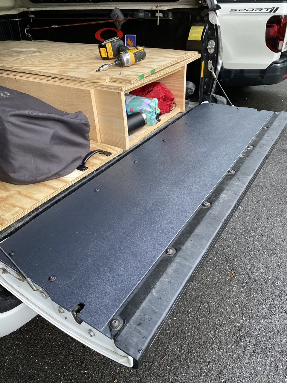

    38AE525C-1EB3-4309-9B1A-F85152DBC359.jpg Well....that was easy. 1/4” textured ABS. Traced the OEM one, jigsaw and router the profile and drill some holes. Doneski. $54

    Thanks man. I’m a machinist so I figured how hard could it be ? I’m just realizing now that this is 3rd gen thread but mine is a 2nd gen. Oops

    Nice!!! Where did you get the ABS from?

    Got it from a local plastics supplier in NH, Piedmont Plastics, I think they have branches all over the country

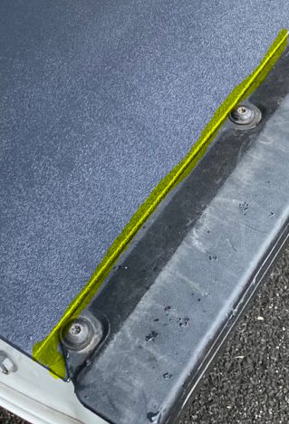

    Quick question - How did you managed to file down the upper edge to overlap the top part? Pics below.

    Used a router at 1/16” depth cut
