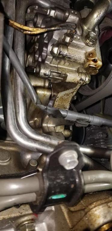

    Thanks, I will update with what happens. Just very little faith in this dealership. I left out the worst part in my initial rant…so I took the Tacoma there in March of 2023 for an oil change, 3 months after they did the 2nd Timing Seal, usually do it my self but is was cold out. Anyway the service advisor tells me the tech said the coolant looks dirty and recommended a flush for $295. I told him to pull up the work order from 3 months earlier and explain to me what part of the truck they dumped all that new coolant into. You can’t make this stuff up!

    Need to check to see if it’s coming from the inspection port gasket of the timing chain cover first. If so it just replacing a gasket which is like 7 bucks. Toyota actually told me it was my timing chain cover and quoted me 5k to take apart and seal. Took it to another dealer who said they were full of shit paid 30 bucks and i was no longer leaking oil. Make sure u check!

    Dgroff10
    Dgroff10 [OP] Member
    Jan 9, 2024
    #441288
    23
    Daryl
    2017 Toyota Tacoma Off road
    Thanks for the tip,
    Did your leak look like this?

    Yes it did
    you can see the metal inspection plate with 4 bolts. Underneath that is a gasket seal that can break down over time and cause a leak as well. My toyota guy says 75% of the time the leak is actually coming from this and not the block. Problem is some dealerships will charge a customer 5k and say they need to seal the block when really all they do is swap a 7 dollar gasket and clean up the area real well.

    Clean it up real good with spray 9 or some other grease buster, watch it for a month or two and if it starts leaking try swinging the power steering pump out of the way and sealing it from the outside with some fipg or other sealer. It’s worth a shot considering Toyota isn’t gonna help and it’s gonna cost you thousands to fix it right

    I’ve seen some cases where it drips oil on the ground not many though. Lot of guys sealed it from the outside with success
