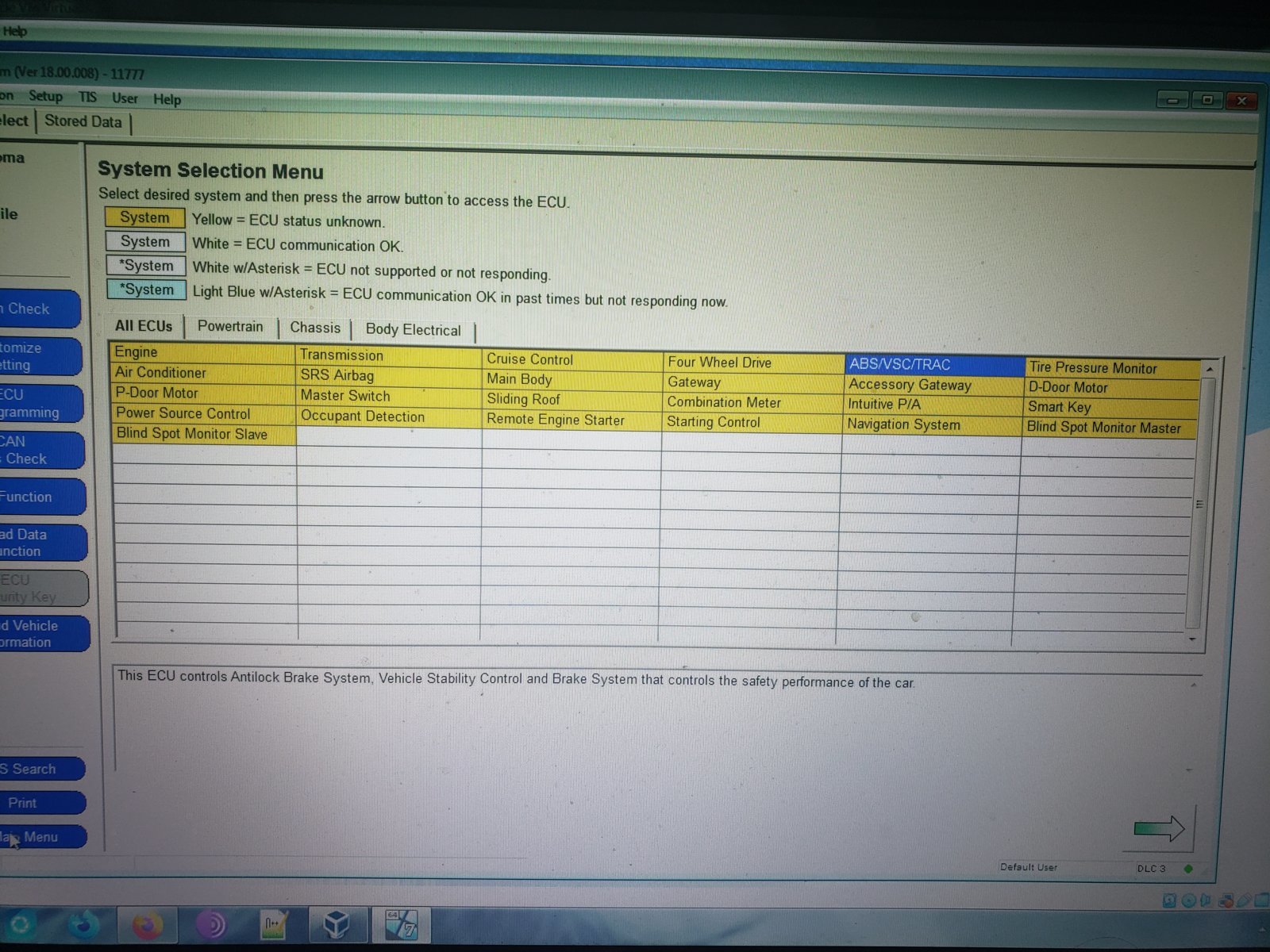

    Do you have any screenshots o the modules that are showing up in techstream?

    I can get that. Yes it has blind side detector.

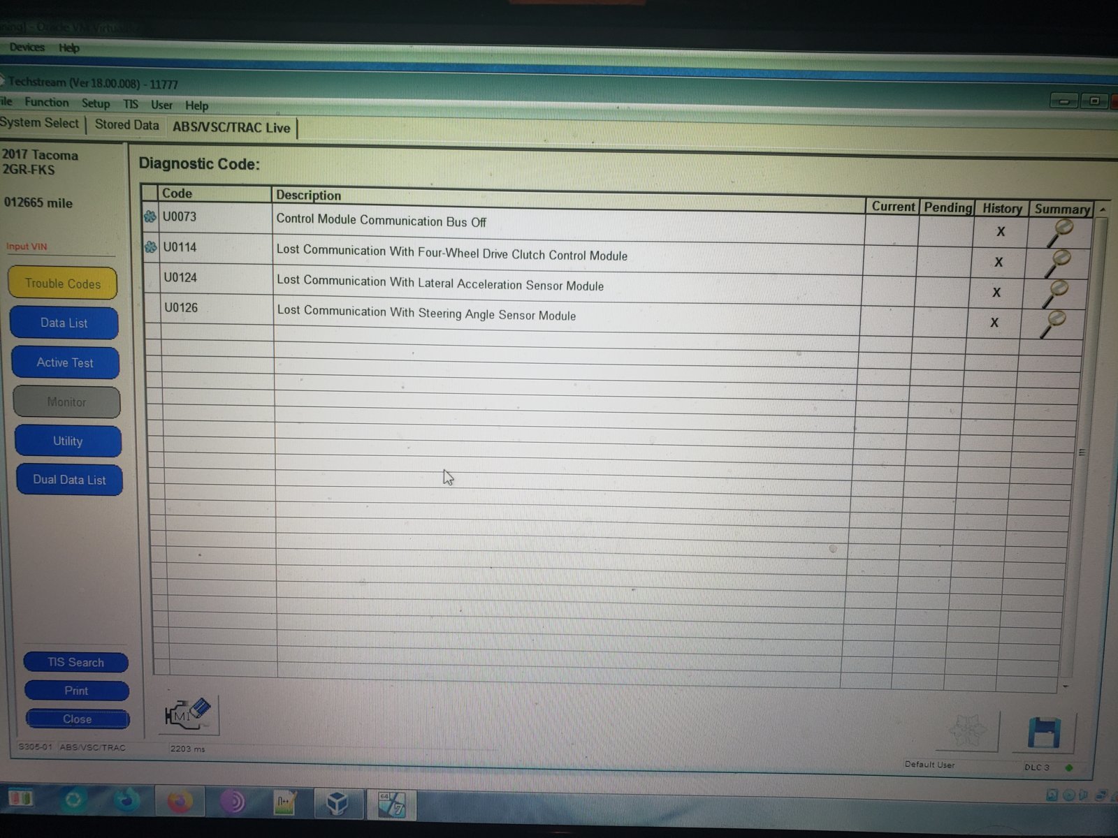

    So I see errors in the ABS module now.
  8. Aug 10, 2024 at 7:39 PM
    #48
    pityocamptes
    pityocamptes [OP] Well-Known Member
    Jan 19, 2018
    #241719
    124

    Yea it's setting those codes because the bus is messed up, we need to determine why the bus is messed up. It isn't that the bus is down completely but by the symptoms of the cluster something is corrupting the data on it.
    One thing you could try is to unplug the ABS module just for grins, I know you will get a bunch of error messages but see if the gauges are still dropping out with it unplugged.
