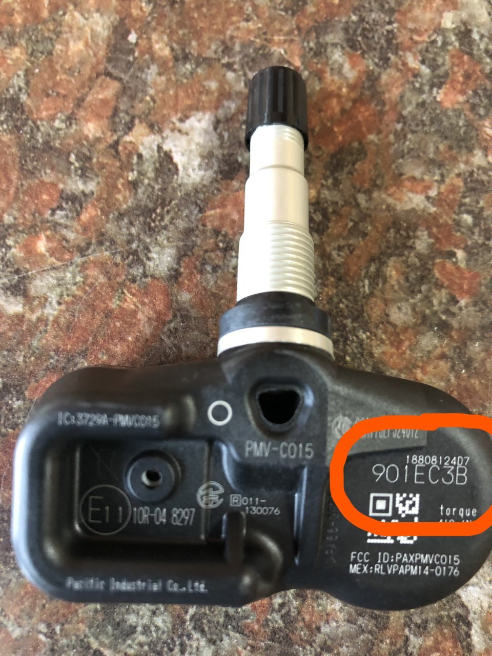

    Tons of threads here about aftermarket sensors. Don't do it! You can find OEM's for less than most dealer prices. I got a set from a dealer in CA a few months ago for around 50 bucks apiece. Your old sensors, if from steel wheels do not fit correctly in the alloys, but you can make them work by flipping them 180. (Doesn't matter, you don't have them)
    When you get new OEM sensors, each code must be registered in the ECU via Techstream.
    Do a quick search here for tons more info.

    There are two ways to get new sensors to work with your truck- have the dealer manually enter the codes from new OEM ones into Techstream as Garyji points out in post 27, or you or someone else will have to use a generic reader/programmer to enter the same matching codes off your OEM ones into the generic sensors. If you don’t have the original OEM sensors anymore, you will not have access to the codes your truck used and will have to have someone with techstream do the programming. Just buying generic sensors alone won’t work, you will still have to get them programmed by someone or with your own programmer.
