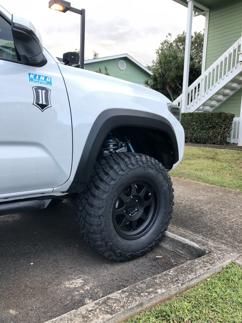

    Thanks so much! With the offset on these Ray10s, there is really minimal tire sticking out. Hawaii is pretty strict on making sure tires arent sticking out. SCS just came out with a new offset Ray 10 and I think they poke out. Check out the SCS thread theres some pics there of the offset.

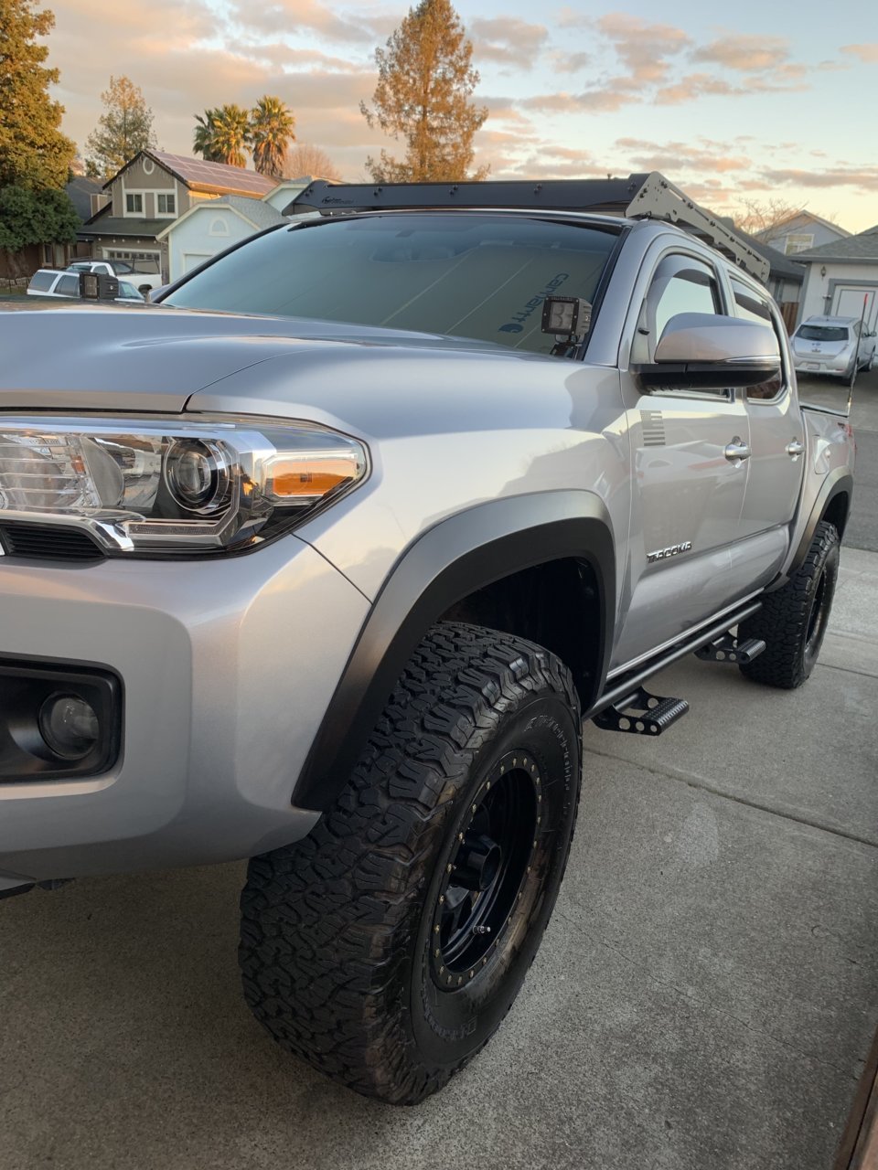

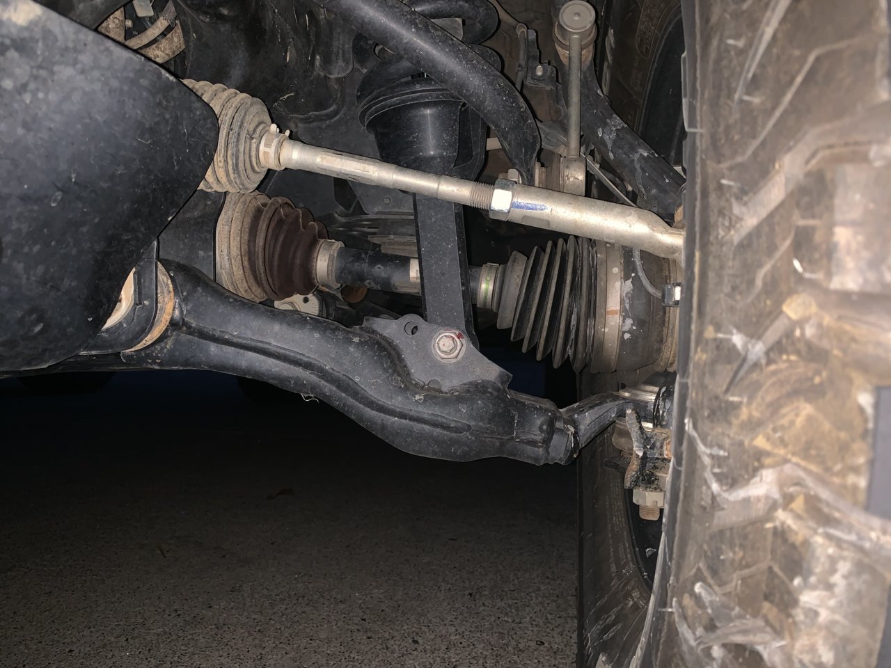

    A342CA60-69DA-49CE-BBF7-725E0011CECA.jpg 9112A0F0-DED4-4FD6-8350-5EA0CAADFDAA.jpg How are ur cv angles/boots at ur ride hight looks about the same as mine and I am worried about my boots...

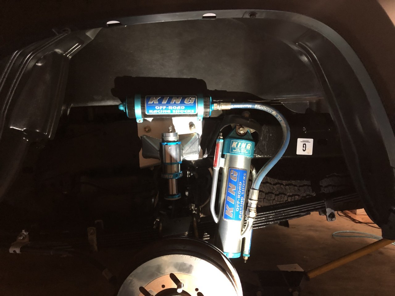

    Added Kings rear bump stop kit. Sadly still waiting inn CBI stuff to come in. Ordered mid November:(

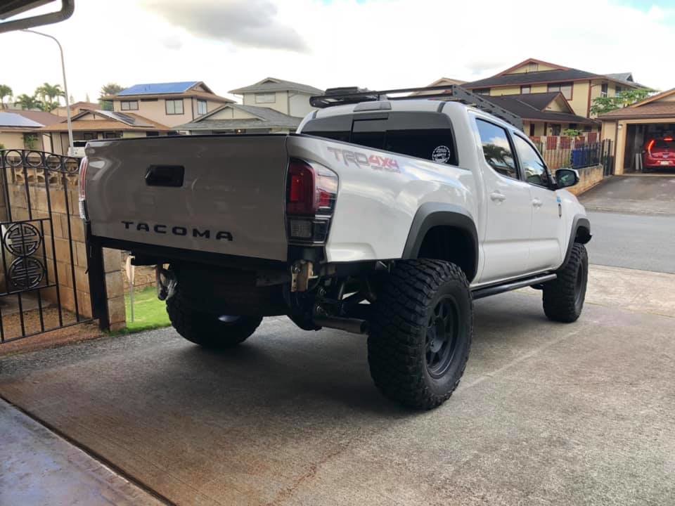

    Lots of updates, sold the Ray10s and Nitto RGs km3 and mr701 on the truck now. Looks really awesome. Happy with the change, Ray10s seem to be pretty common now a days.

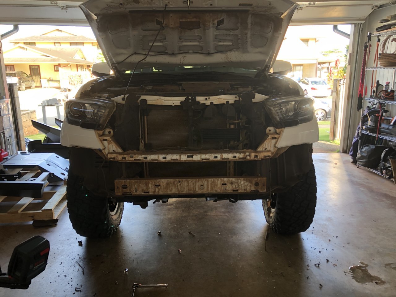

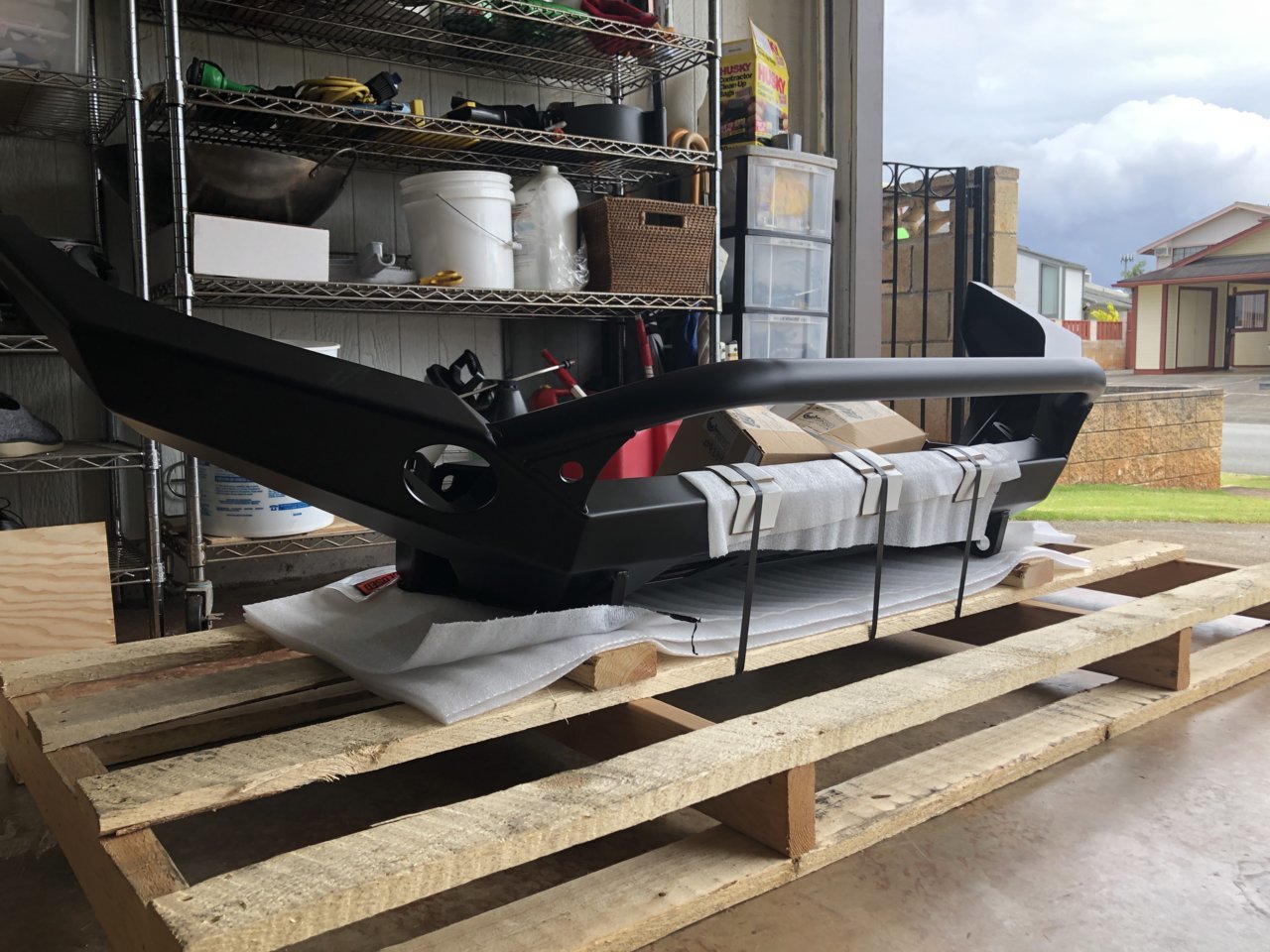

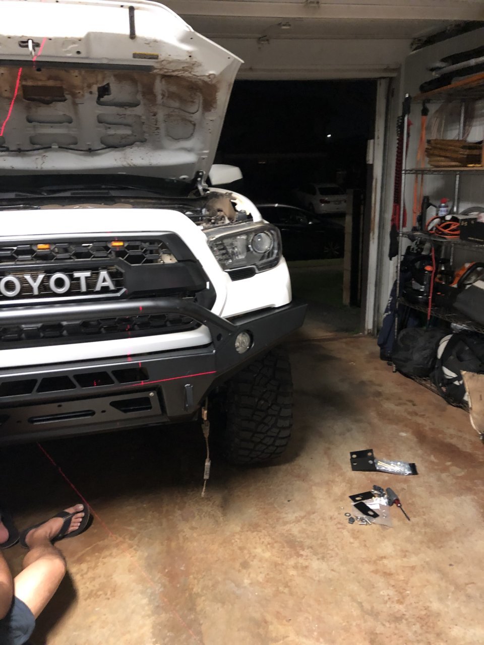

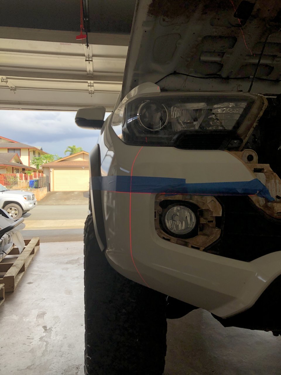

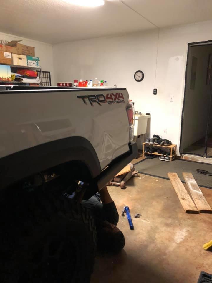

    After almost 6 moths all my cbi stuff finally made it. It’s been quite a struggle getting it all. Started with front bumper. I watched pretty much every YouTube video on Tacoma bumper cutting decided on this method leaving the cover on and cutting. Used a laser level to get a nice line. Angle grinder with a cut wheel to make the initial cut right below my intended line then finished it up by swapping on some sand paper on the angle grinder to get a nice smooth line. This was my first ever experience with an angle grinder and cutting plastic, I used goggles but I think a face shield would have been better and you need gloves/long sleeves, the plastics gets really hot when cutting and burns. Anyhow cut was done mounted up the bumper with oe fogs. The bumper is sitting slightly crooked, need to realign. Going to put the CBI skid plate and align the bumper today. HC rear will go on next week.
