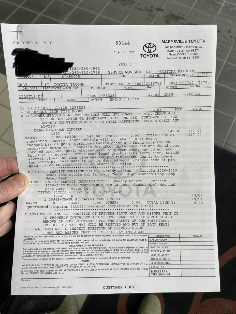

    Just wanted to update you guys. The dealership called and finally were able to get the truck running. They stuck a probe in one of the wiring harness ports and the vehicle started up.
    They said it has been starting up every time since. I asked the service manager if the truck would do this again and leave me stranded and she said she doesn't know. They still don’t know what caused the issue. They said they could replace wiring harness etc and still wouldn’t know if that would resolve the issue.

  20. Feb 23, 2023 at 6:13 AM
    #60
    TacomaGuy36
    TacomaGuy36 [OP] Member
    Oct 20, 2019
    #308529
    12
    Ben
    Everett WA
    2017 Gray TRD Off Road Tacoma
    Well here is the fix. Highly recommend Marysville Toyota! They only charged me for a diagnostic! Maybe this will help someone in the future with the same problem.
