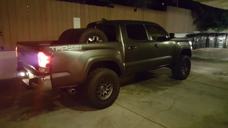

    I finally had my lift installed today. Took all day but was well worth it! 888s set at 0, 5100s all around, LR UCAs, HS 3 leaf AAL, 285/70/17s on Ray's 10s. Overload leaf is removed and 1/4 inch top plate spacer is in installed on driver side. Surprisingly no rubbing, trimming of plastic, or cab mount chop had to be done. No rub at full lock neither. I'll get a chance to test it out and get a better feel for things tomorrow on the trails. Sorry for the bad pics. I'll post better ones tomorrow.

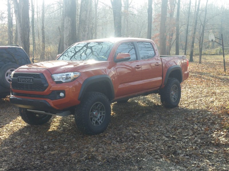

    Thank you! No gap. you can modify the bumper brackets to fix the problem. Got the 1" body lift from Toytec, no problems at all. I'll post pic.

    Here

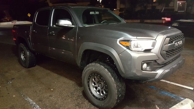

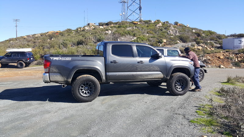

    Here are better pics of my rig in daylight. Tested the new suspension today. Runs pretty awesome. Minimal rub and runs way better than the stock TRD suspension.

    It has a very slight rake with the front end being a tad bit higher only because the shocks haven't really had time to settle. When I mean slightly, I mean it's very hard to notice unless you're really anal about it. If you scroll up to my other post, you can have an idea of what it would look like on yours. I've also heard of people leaving the overload leaf in and when the front end settles, the rear end sits a tad bit higher than the front. Overall, I'm pretty satisfied with how the truck looks. A few more trail runs and the front end should settle to where I want it.
