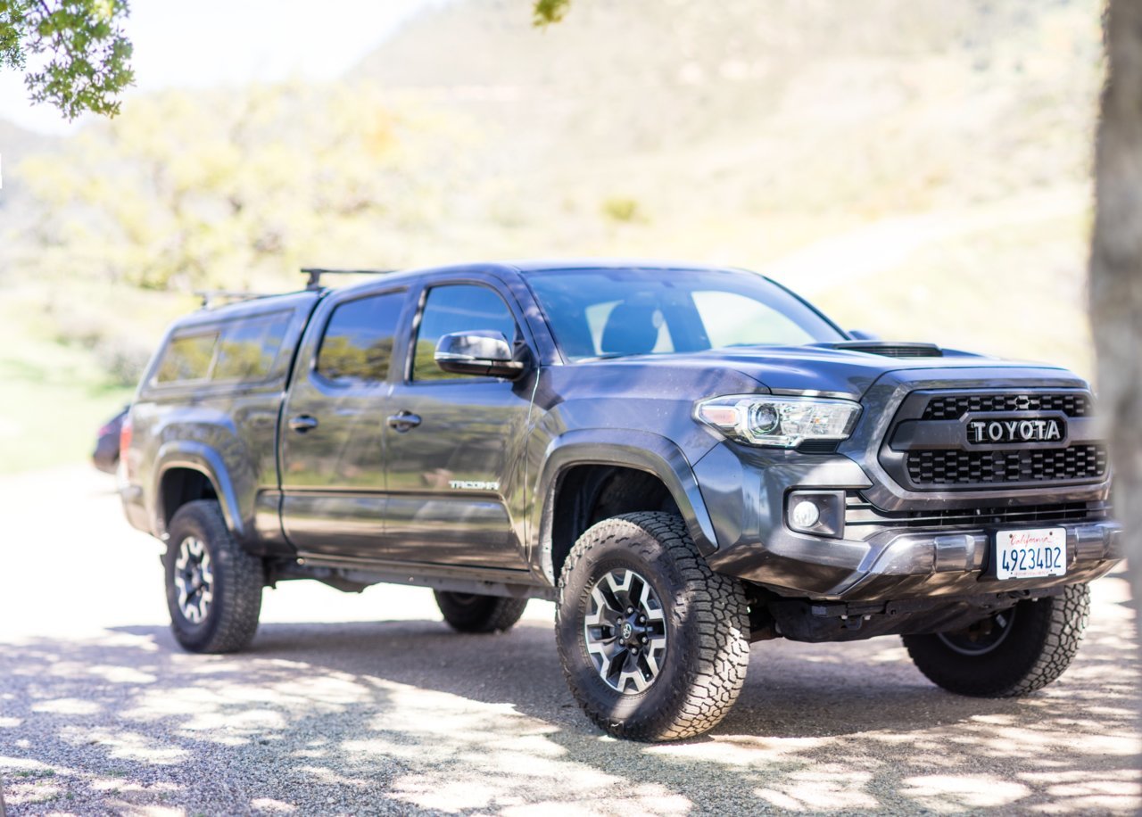

    #23
    jimbo805
    jimbo805 [OP] Active Member
    Feb 2, 2019
    #281551
    38
    Ventura, CA
    2017 MGM Tacoma DCLB TRD Sport
    EB112DE9-C2A4-4B4D-A5D7-842A6C562895.jpg Here’s a photo of her, this is when I had the wild peaks.
