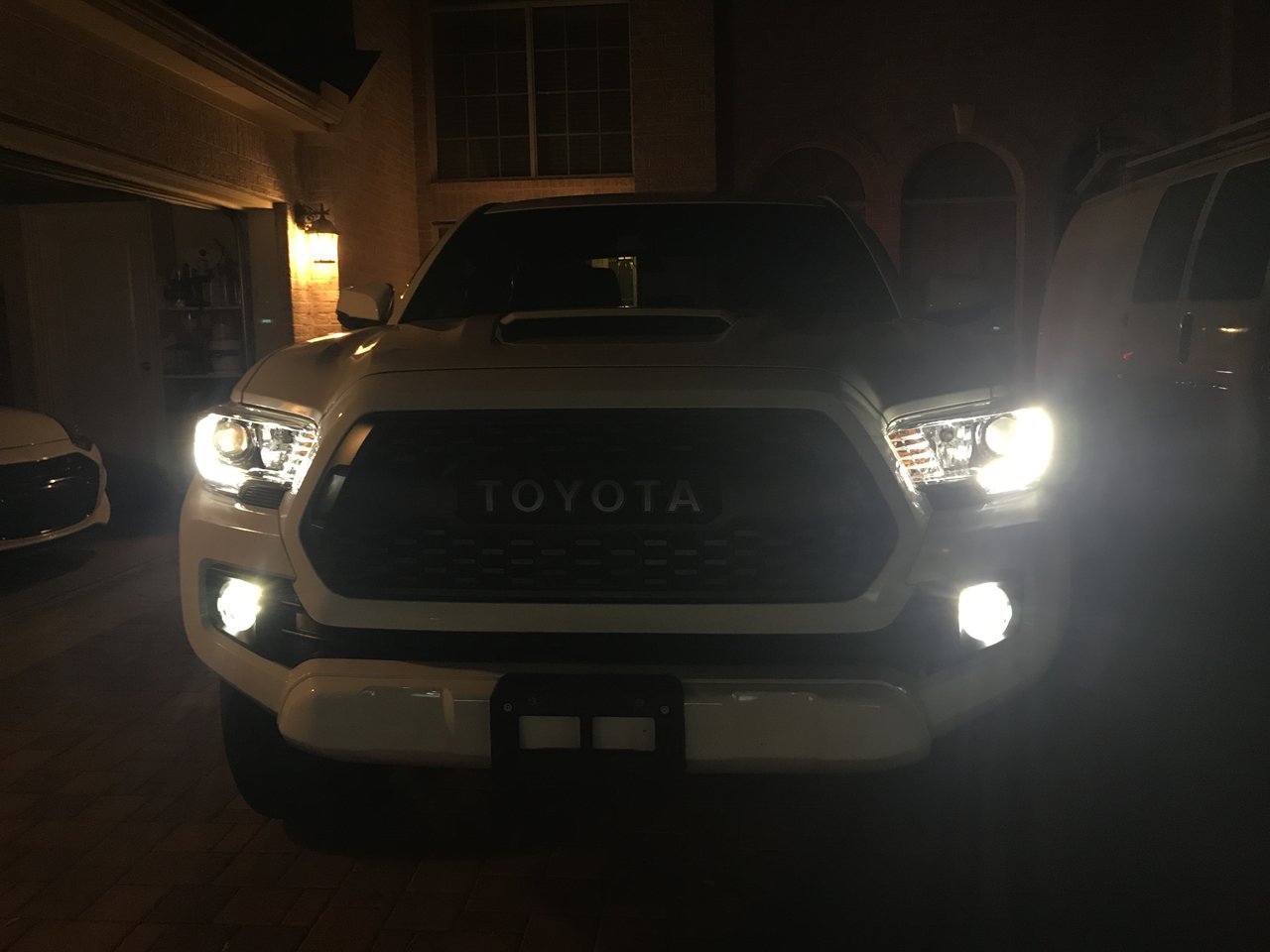

    Thanks! You're very welcome!
    So how are you liking your new fogs?

    2017 DCSB TRD Sport. TRD Pro Grille. Morimoto Elite 35W HID Headlights. Morimoto XB LED Fog Lights. Clazzio All Black Leather Seat Covers. 32" LED Light Bar Bumper Stealth Mount. BHLM. Raptor Light Kit. Leer 100R. Bilstein 6112/5100 set at 3rd notch. LT275/70-17 C-Load Hercules Terra Trac AT2. Bora .750" Wheel Spacers.
    So far I'm really liking them. The Morimoto fogs match the color of the LED DRLs perfectly! Today I drove around with just the DRLs and Fogs on, and looked really nice. I also have the Morimoto Elite HID kit as well and they pair nicely with each other. Extremely happy with the install!

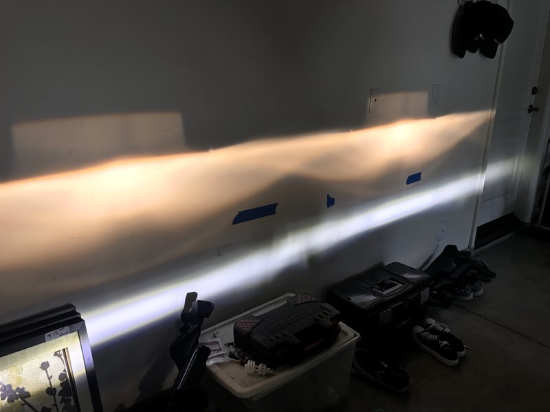

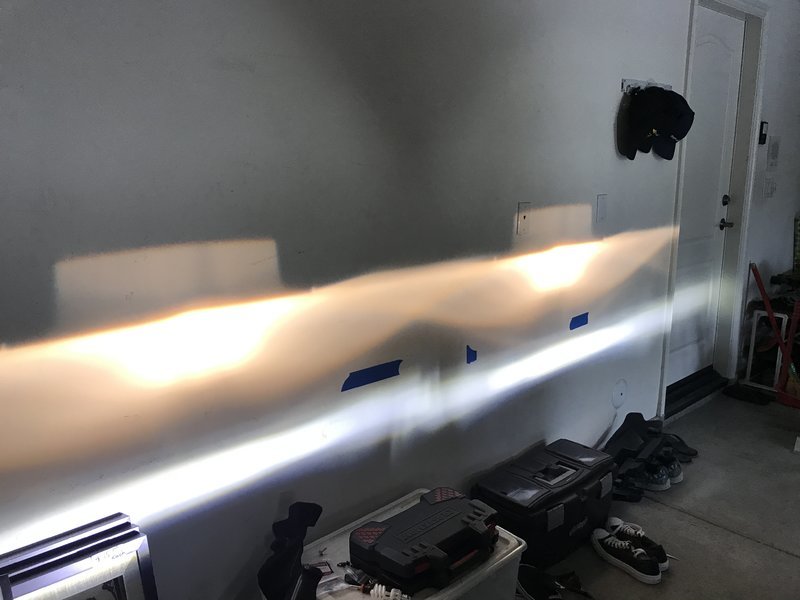

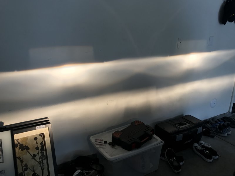

    Just installed my Morimoto Fog Lights! Pretty easy install. Removed the Grill and installed from the top. Can confirm as well that Green goes to Red and Black goes to White. Not sure if my light adjustment level is correct so if anyone could confirm that would be helpful!
    First is Stock Fog Lights:
    This is the Morimoto's installed with no adjustments. The bottom of the tape is where the top of the stock light cut off from the previous picture:
    Now this is after I made the adjustment and move the Morimoto's top of the light to the bottom of the tape:
    Would you say that's the correct level or do I need to make adjustments? I appreciate your help! HID are next upgrade!

    Nice, exactly how I did mine. Looks about right.

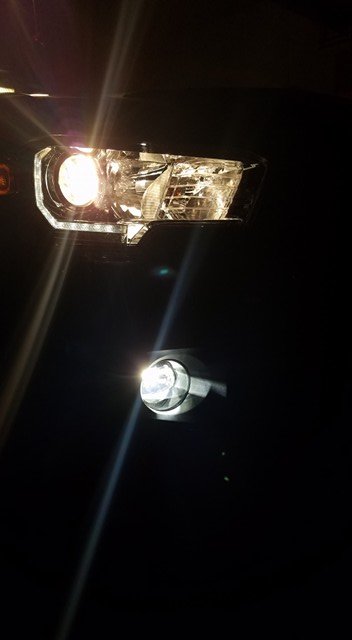

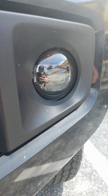

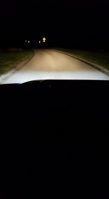

    I installed mine yesterday by going through the fender well. Wish I would have seen this thread first :frusty: Would have been much easier to take off the grill or just go through the top.
    Anyway, here are some photos.
    My concern is that when sitting in the driver seat, I am unable to actually see the light when its on unless i lean forward enough to see over the hood.
    Is this a good level to have them at? They cut off just below where the low beam hits.
    arnette64, SilverII and RobP62 like this.

    I would raise them up to get rid of the dark space directly under the headlights, just to the point where the light from the fogs is just touching the light from the headlights.
