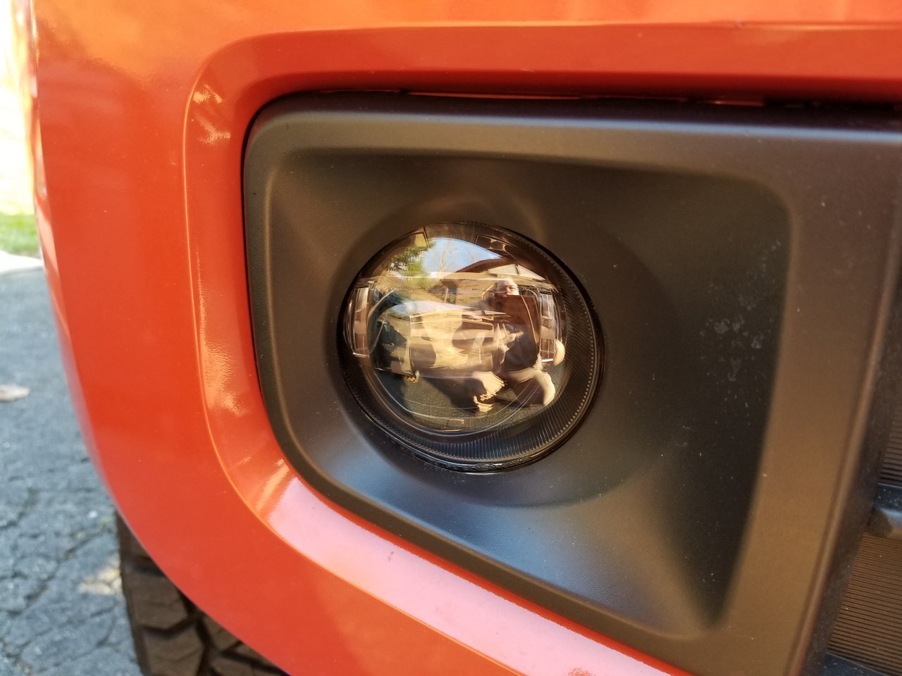

    Ok, just installed the fogs. Definitely for me, removing the grill and the two air deflectors behind it which took 5 minutes total was easy enough.
    Wiring is the same as everyone else. Red/green, black/white. 2017 TRD Sport with the tech package .

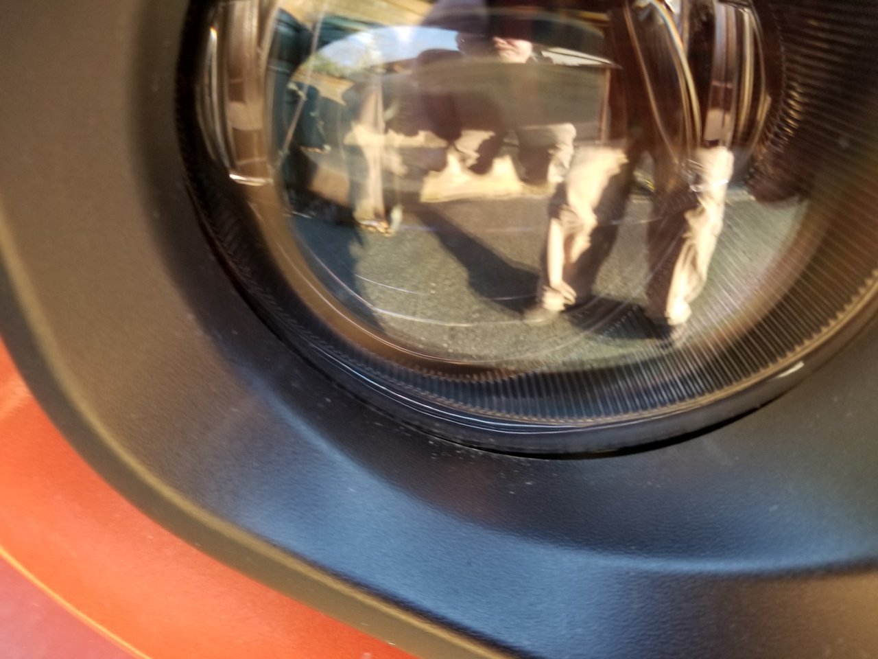

    Ok, I installed one, there was a gap between the housing and shroud. I had the two inboard tabs in the two slots. Had the screw in. It looked almost like the gap in the OEM side but definitely more. When I put the other side in, I put the two tabs in front of the two slots and put the screw in and there was no gap. I redid the other side and the gap disappeared.
    I guess I'll have to wait until tonight to see if there is a huge gap in the beam of light in the middle. If so I'll redo it and live with the gap. It was definitely more of a gap than the OEM housing. Enough to make wonder if I had it right. I'm getting ready to run and do some chores. Oh, I did wiggle the housing and it felt secure. I'm just worried I have it wrong.
    Rob
    Parker315, SilverII and 4x4yotaphan like this.

    Correct me if I'm wrong but aren't those tabs what keeps it from falling off on the side that doesn't have a screw in it? So by not putting them in the tabs they are subject to moving around?

    I drove the shit outta it tonight and never saw any bounce. Still unsure if it's ok though. When I put the lights in they actually felt very secure like this.
    I'm hoping someone else can chime in.

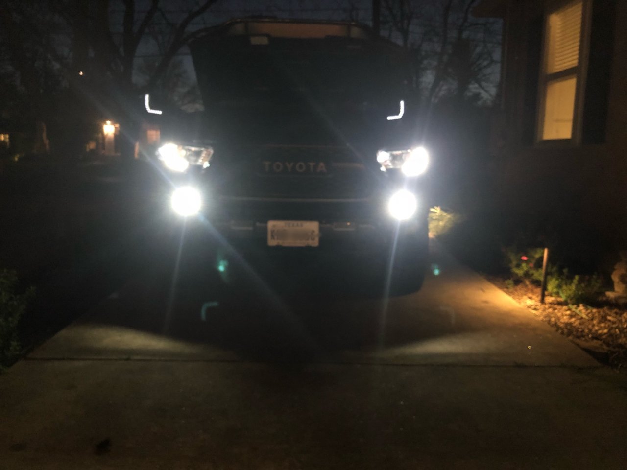

    Received mine in the mail yesterday. Installed tonight.
    Easy. From the top.
    Picture is awkward. Getting a glare of the DRL’s above where they actually are.

    How does the color temp of the Hikari’s blend in with the fogs? Mine are a little different. The DRL’s and the fogs are spot on

    I honestly can't tell where one stops and the other begins. To me all three are pure white. Now, the fogs are definitely not as bright as the Hikaris but I can't tell any difference in temp. I have yet to be flashed in any condition out here in the country.
    The other night it was a little foggy and I was turning off the LBs leaving the DRL and Fogs on and it was acceptable. At 50 - 60 in the fog, out here in the country, it's not something I will do all the time. No need to, because I didn't feel like the Low Beams were throwing a lot of reflections. Definitely not enough to cause concern. I expected more considering how much whiter they are than the OEM Halogens.
