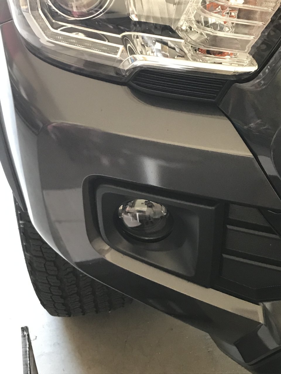

    Installed and love them and they are super bright. I went in through the top, was a bit tricky feeling your way around but was done in about 30 minutes. Photo really does not do justice.
