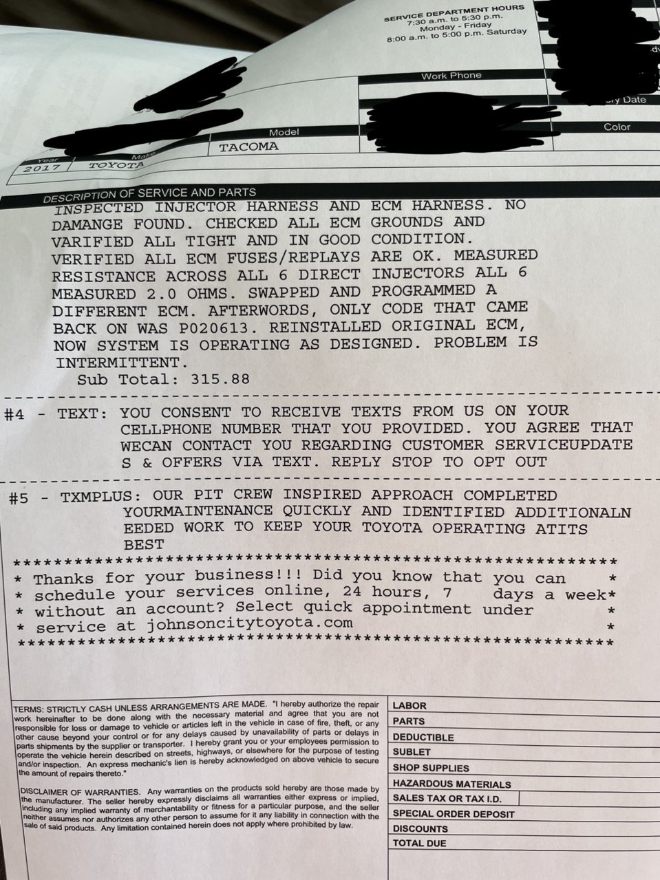

    #36
    Smoky Mountain Taco
    Smoky Mountain Taco [OP] Member
    Mar 23, 2021
    #360313
    22
    Russell
    2017 Gray Taco OR
    E5EB247D-54EE-4E37-B15F-0A7F0DC828A4.jpg So apparently everything thing is working normally and it’s an intermittent issue.......?
  17. Mar 24, 2021 at 5:07 PM
    #37
    tacoman45
    tacoman45 Well-Known Member
    Feb 20, 2019
    #283801
    1,369
    Orygun
    2014 TRD OR DCSB - MGM
    I've heard of someone doing this to get back at somebody. It's alot easier to overlook since diesel smells (somewhat) similar to gasoline and won't kill the motor immediately.
    I'm not saying sugar in the tank is easy to notice, but diesel is alot easier to dismiss as neglect by the owner than outright revenge by someone else. More time passes as the shop tries to troubleshoot the issue and the police have a harder time proving a crime was committed by someone else.

    Now's your chance! It's running fine, no dash lights? Go straight to Carmax, or jump on carvana. Get out while you can.

  19. Mar 24, 2021 at 5:37 PM
    #39
    auskip07
    auskip07 Well-Known Member
    Jan 1, 2019
    #277665
    4,376
    Skip
    Atlanta, Ga
    2019 TACOMA SR V6 SC , 4X4, AUTO, 4.88, 265/75 r16
    Diesel isn't doing this to the engine.
    Hooper89 likes this.
  20. Mar 24, 2021 at 6:37 PM
    #40
    ORtoCOTaco
    ORtoCOTaco Well-Known Member
    Jan 18, 2020
    #316468
    206
    Colorado
    2018 White Tacoma TRD Off Road DCSB 4x4
    BodyArmor 4x4 HiLine Winch Bumper, Warn Zeon 10-S, Uptop Bravo Roof Rack, ExtremeLED Super Stealth 40" LED Light Bar, DV8 Offroad 20-Inch BRS Pro Series LED Light Bar, Truxedo Roll-Up Tonneau Cover, Automatic Tailgate Lock, Trailgate panel, cheap Amazon ditch lights.
    Check the main engine wiring harness where it goes through the firewall?
