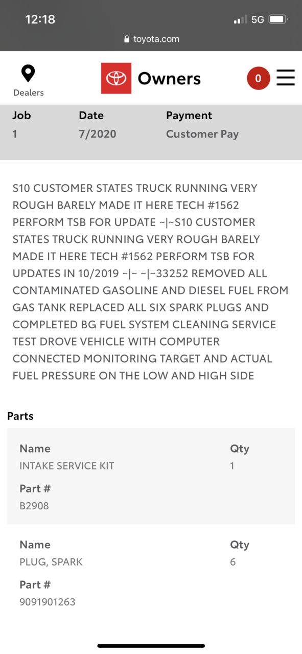

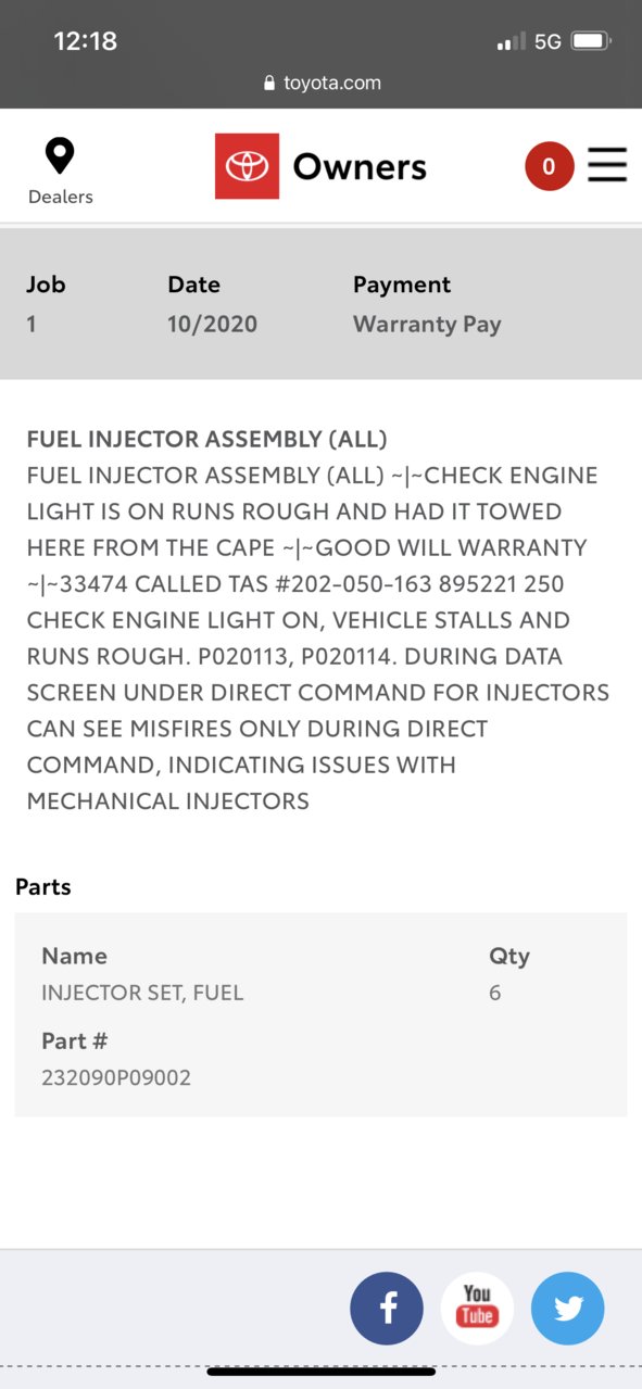

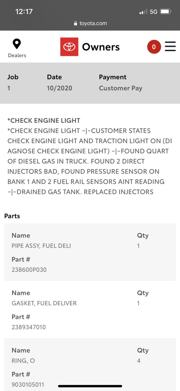

    Just found these on my service history on the Toyota page. All that CarFax described was “fuel injector serviced”.

    and it just went away magically? Think there could be more diesel in the tank?

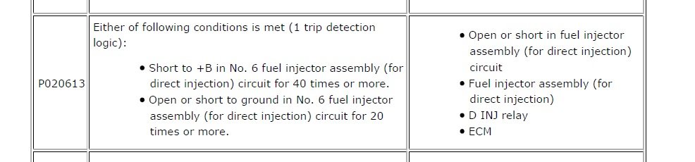

    According to the tech notes, it only popped one recurring code; P020613.
