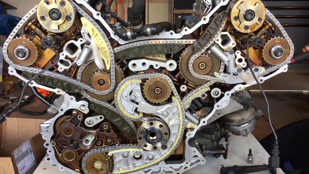

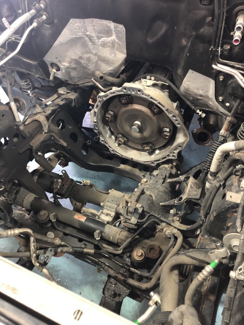

    It's back in, just gotta add fluids and intake manifold, so far 12 hours in. Here's the half way photos.

    Am I the only one who wonders about the longevity of an 8 feet timing chain?o_O

    The 2nd gen 4.0's stretch over time, so far I've only seen this on one 2GR from a highlander. Toyotas are stout as fuck.
    Tundras use 2 seperate chains, its actually way harder to set up. The 2GR/1GR is cake to set up. You can actually see the yellow timing mark in my photo.

    Quikfix seat risers and lic plate mount, MESO interior and stage 1 tails, glove box and console dividers, shelf for center console, FACTOR 55 hitch link, TC bed stiffeners, OE bed mat,
    Doesn't bother the guys at Audi......
