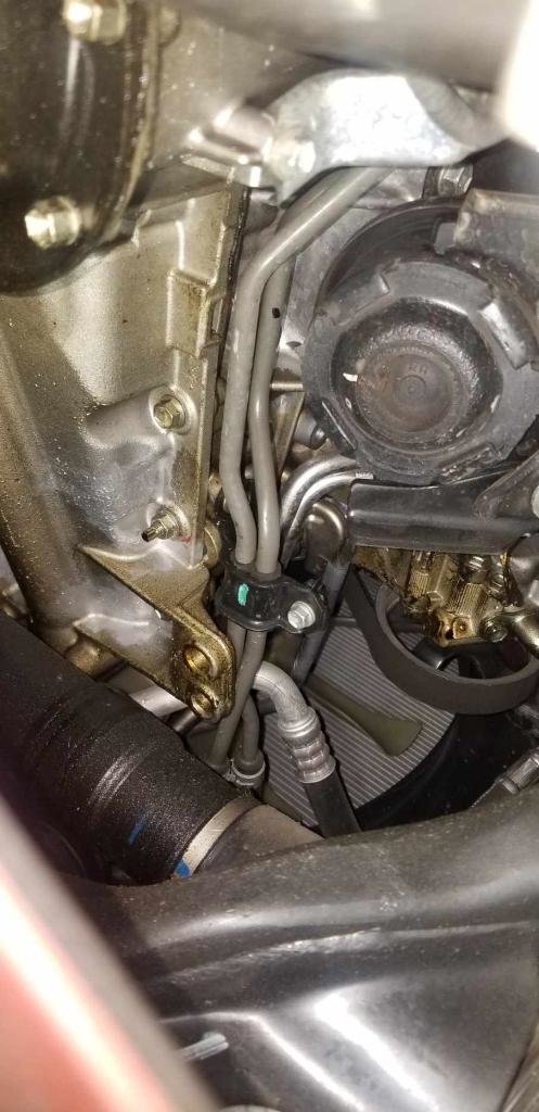

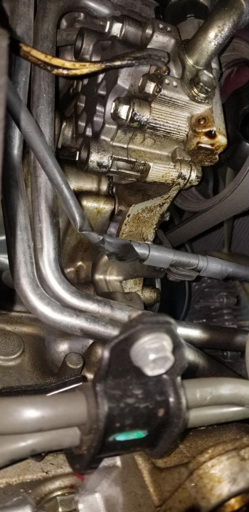

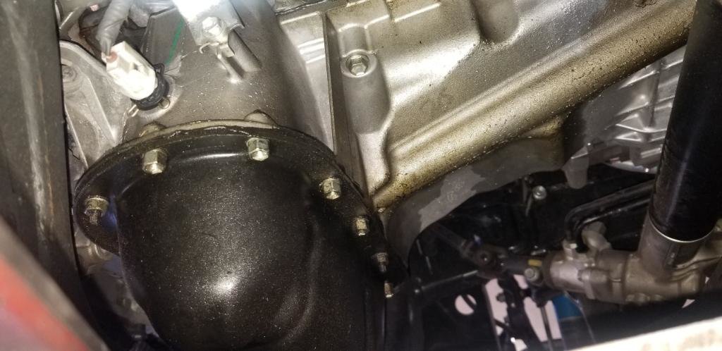

    what are the signs of this "timing chain cover leak" that I need to monitor? didn't know it was a thing!

    Look for oil under the front of the motor. Most say that they don't even have drops on their driveway. There have been a handful of threads about it. I believe the root cause was improperly applied liquid gasket where the timing cover spans over the joint between the crankcase and heads.
    Thinking about this, I wonder if there is an external fix? Heavy cleaning and a material like Threebond / Form-a-Gasket, but made to patch externally?
    Of course, we lived for 10s of thousand of miles with a weep from a joint in the crankcase layers on our volvo. Pretty harmless except that the car marked its territory on the garage floor. Too small of a volume to even register over an OCI.

    passenger side. Can’t really see it from top view unless you know exactly where it is. And if you have a skid plate you might not see it from under. If you drive a lot of fwy. The wind might spread it And you’ll never see it until oil change.
    Also, I don’t know if is a California thing. But if you don’t tell them that is dripping to the ground. Toyota doesn’t consider it a leak and they won’t cover it.
